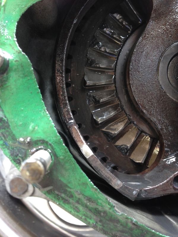

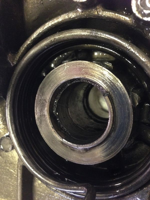

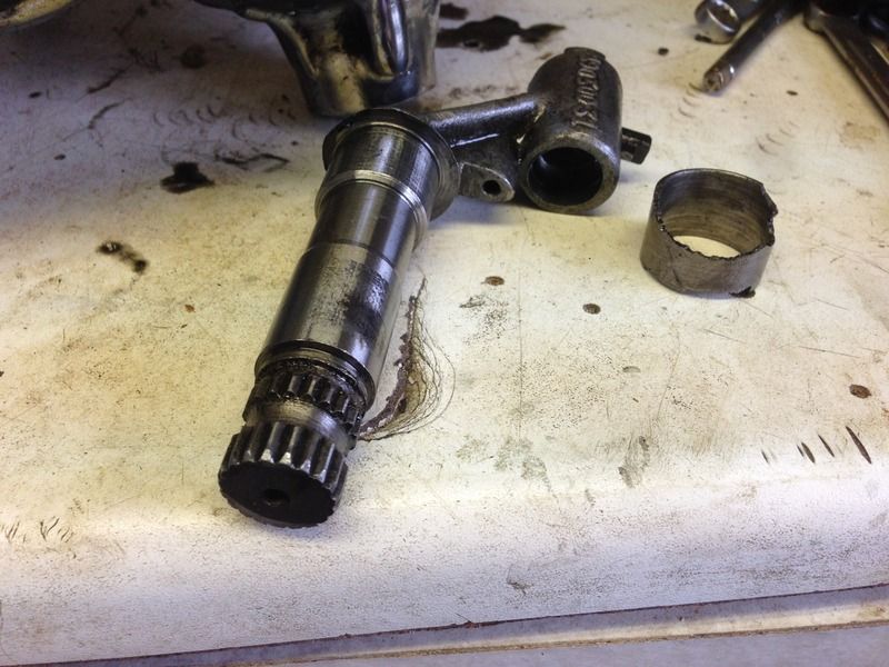

Ok so last week kickstarted my TS1 and felt something give but didn't think to much of it (20+ years of lambrettas should have told me not to proceed) but I popped to the shops came home and put it away. This morning I open up the casing and its carnage!, the kickstart shaft piston circlip and spring are sitting in the bottom of the casing nestled amongst a pile of debris that used to be part of the 1st gear kickstart teeth!. Now I understand that a full strip and check/replace of all components is required and will be done but I wanted to seek opinions on the following:

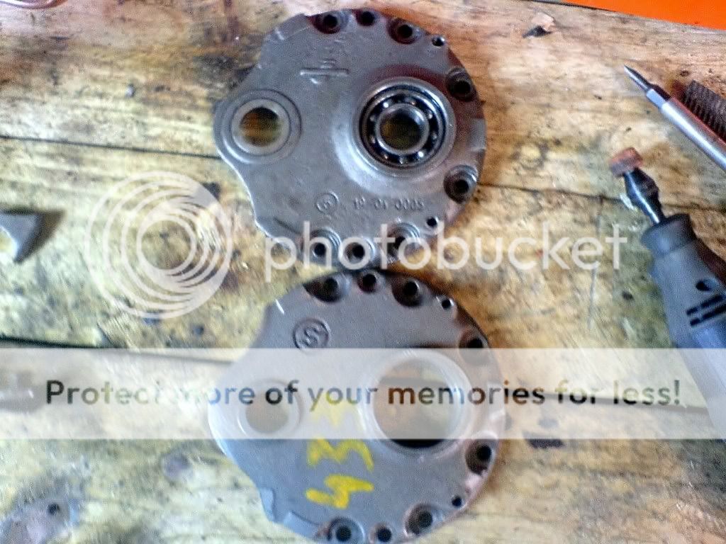

It currently has the GP ramp but I have heard its better to convert to LI/SX type for more leverage, is this worth doing?
I should say so. People seem to prefer it because you can adjust the ramp. And it seems relatively easy to do for those with a bit of technical savvy.

Yes is the answer. It's very easy to do and once you've done your 1st one you'll never look back.
All you need is a drill, 5.5mm drill bit and a decent 6mm metric tap. It's one of the most worthwhile modifications to do in my opinion.

Thanks for the pics looks simple enough, do I need to change to an LI type endplate?

You just cut the ramp off the end plate you already have. It should be machined for the casing you're using.

ridden not hidden wrote:Thanks for the pics looks simple enough, do I need to change to an LI type endplate?
As said above just cut the ramp off - much better adjustment also takes the pressure of the kickstart off the endplate

Thanks chaps definitely going to do this mod. I have a concern about the kickstart shaft that I am using because the circlip and washer have obviously let go along with the spring. do you think this is likely to happen again or should I replace the shaft?

http://www.lambrettaspares.com/spares/k ... 20scl.html
If you haven't already, fit one of these circlips.
