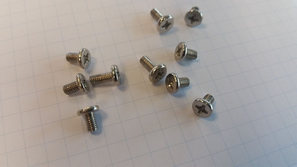

Thanks Wack 63. And in a separate eureka moment I came across these loose screws from a PC that I stripped. They are M3 and some are of the correct length, but they are stainless steel, rather than brass, but don't think that will be an issue.
wack 63
Posts: 1254
Main scooter: '71 GP TS1
Location: Lincs
Just make sure to put a dab of Loctite on them, then just gently nip up. Also check the heads allow the block to fully seat flat in the cylinder.
