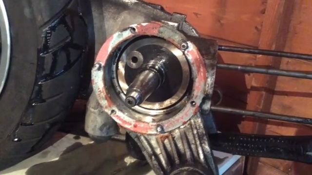

alanscottj
Posts: 960
Stripped engine this morning. Looks like drive side bearing knackered :roll: to be honest when I spin the bearing with my fingers and try and move it it feels ok, no movement at all but with the crank in place, the cranks moves like this :
Click on image for video :D
Lambretta Series 2 Rat - RB260, SuperTourer, Cyclone 5 gearbox πŸ˜ŽπŸ‘
HxPaul
Posts: 1110
Location: Halifax,Yorkshire
To be honest,that looks pretty normal
