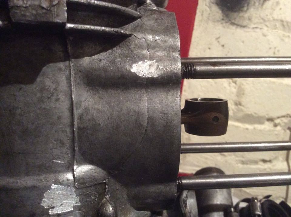

Crack on casing........
alanscottj
Posts: 960
Found this crack on my casing .................... thoughts???? It is only on the outside, no signs whatsoever inside the casing :roll:

Seen 2 like this in the last six months just deep flash mark same shape :shock: , I had a melt down when first spotted one on my rb mate said look at mine ooo,er no leak whatsoever, Indian case is it ?
alanscottj
Posts: 960
Den 08 wrote:Seen 2 like this in the last six months just deep flash mark same shape :shock: , I had a melt down when first spotted one on my rb mate said look at mine ooo,er no leak whatsoever, Indian case is it ?
Yeah, Indian, whats a 'flash mark"?

I am no expert, but was told, the thick bead that looks like a joint is the sand cast line but when taken out they some times set to quick and something happens to the last couple mm of alloy, some sort of shrinkage!! as I said no expert and could just Chinese whispers but it sort of sounded convincing anyway mine is exactly the same right down to the little jagged pointy bit at the bottom of pic which looks like it will fall off if prodded but I have done about 550 miles and it has quite high compression showing no signs of an air or week in that area, oh and yes both Indian cases I've seen maybe a Friday job? Lol
It is not a good though is it.
Sorry for long answer and may not be correct regarding flash mark.

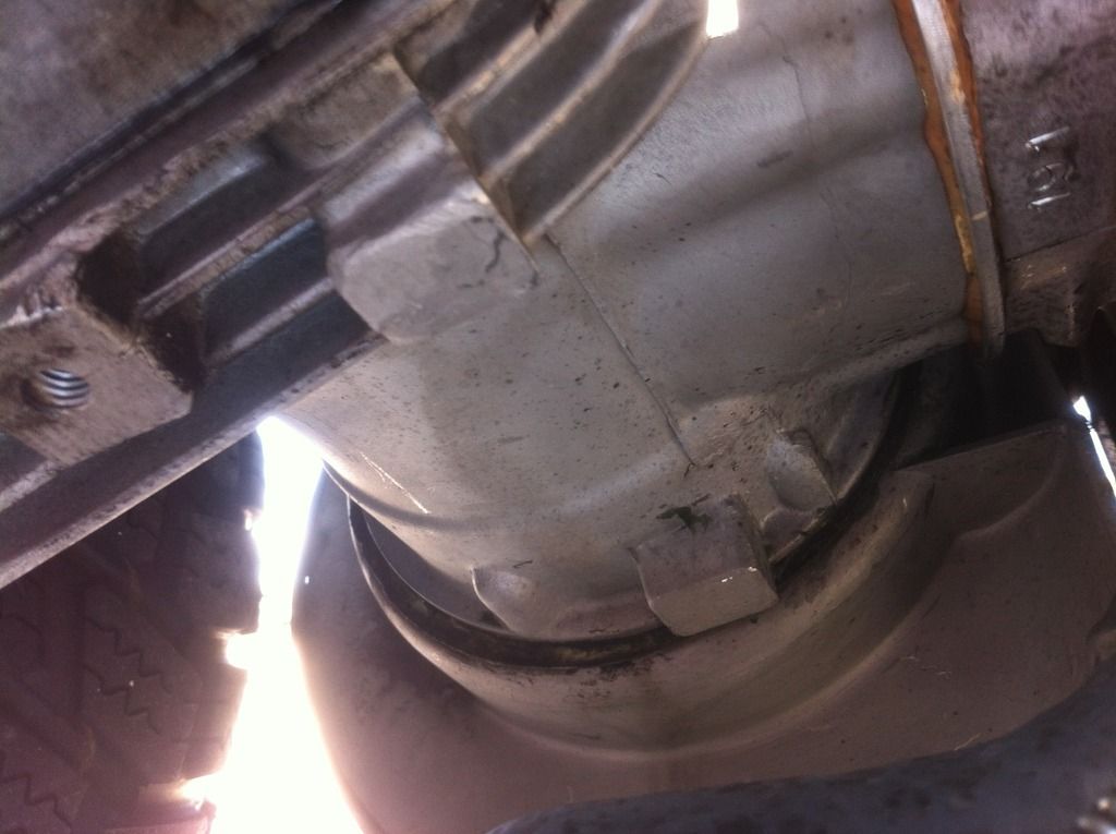

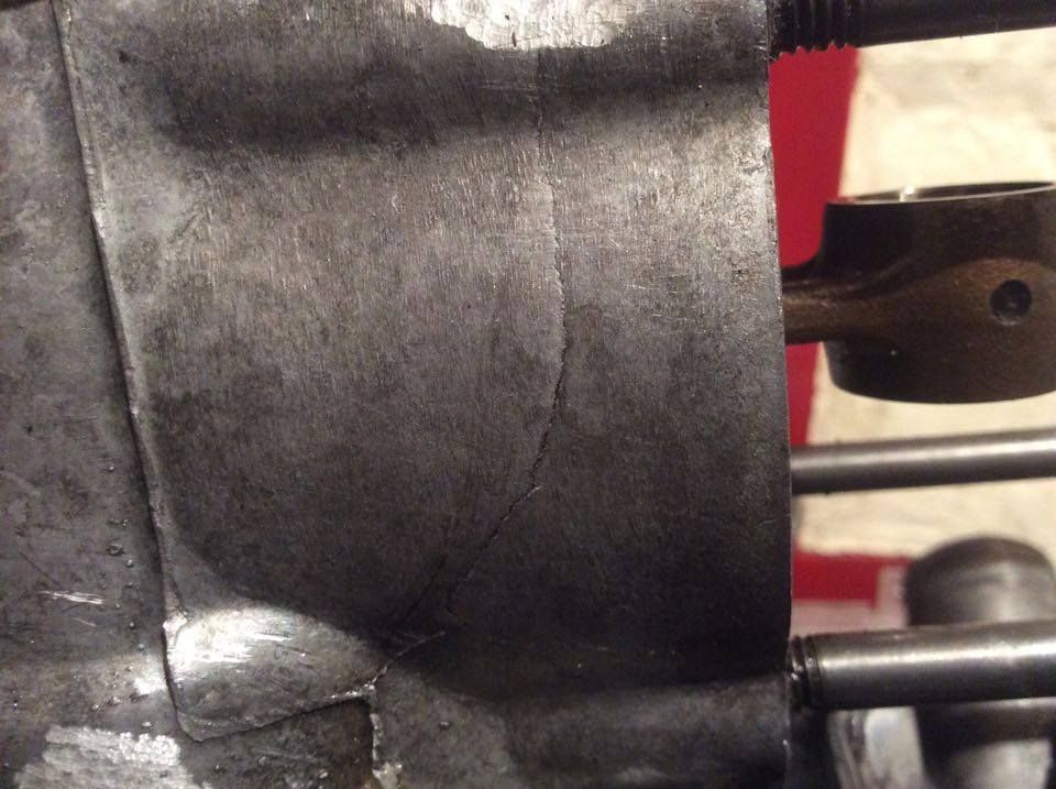

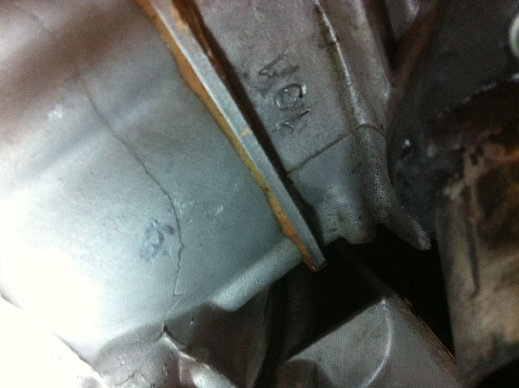

Has your got the hairline crack to the right of the bead?

Twins! Just had one of the local lads have a look at mine as well and he confirmed what you said mate. It's put my mind at rest any way, many thanks ;)
