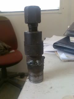

my fly wheel sheered clean off ,i had messed about trying to get it to clear ,also knacked the stator as well ,mainly when i had to weld the puller on.
to get the rest off the crank.
