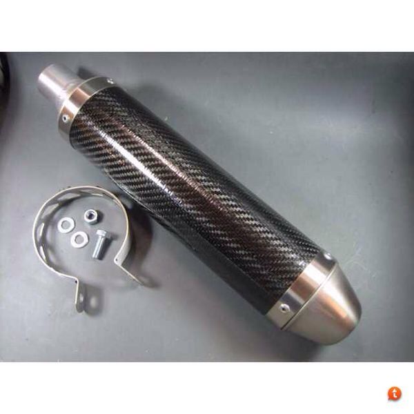

Hi guys,
I would like an exhaust end can like the one in photo for my krp3.
Is it possible ?
Any advice or feedback ?
It's for my DL 125 (GP200 engine).
Thanks.
JB

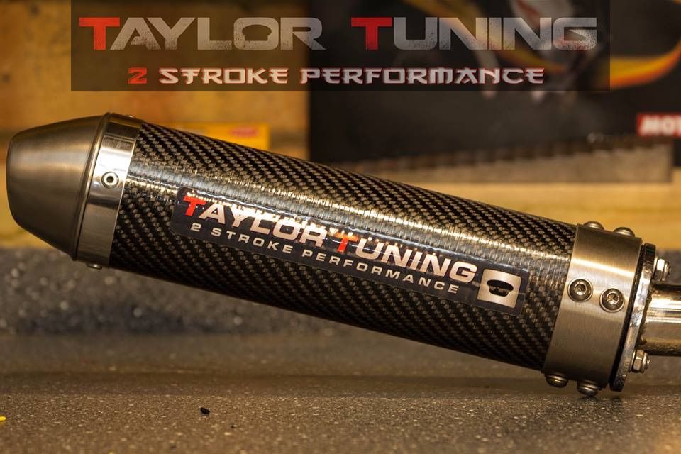

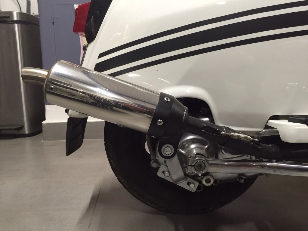

You'll have to replace the end section for one with a flat plate to attach the Taylor type silencer.These are on Franspeed type exhausts and Chiselspeed.The holes will have to line up so you might have to drill new ones.You could replace your silencer with carbon tube and reassemble it.You can get the tube from PJ engineering website.
