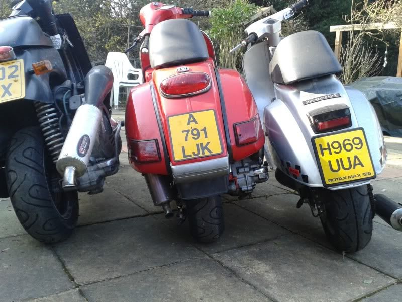

Side stands, Fat tyres, PM pipes 8-)

is it me or are all the wide tyre conversions not centre with the frame?
the one above still looks like the centre of the tyre is slightly to the left
only asking as mine is the same, when you look at it from the rear the tyre looks like it still needs moving over about another 5mm
