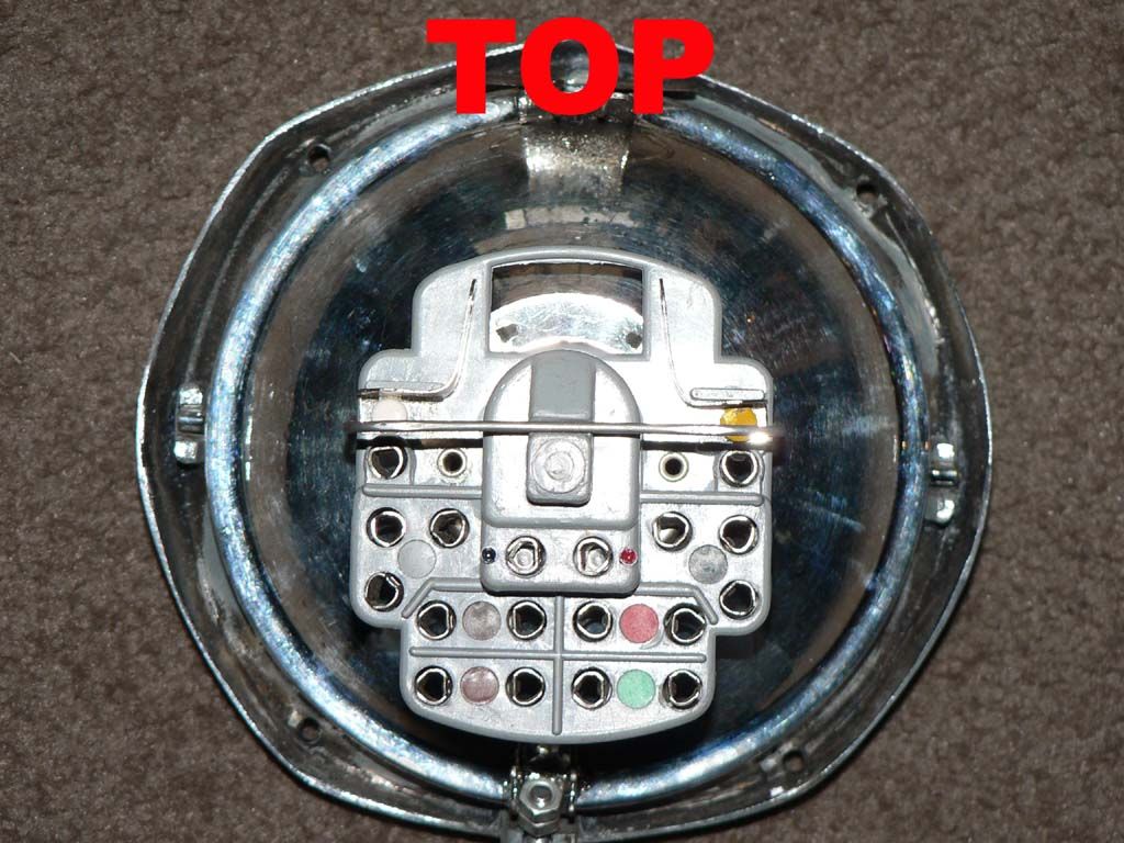

Minority
Posts: 673
Main scooter: Li230 S3
I think what Coaster was refering to was all the other wires (not the lights) that use the normal headlamp connector as a junction box like this CEV one:
Evesy
Posts: 49
Joined: Tue Feb 26, 2013 11:17 pm
Main scooter: Jet 200 with Imola 186
Location: Norwich
Yes that has been taken out and discarded. All the wires have been soldered together and shrink wrapped at the joints. The lad who did it for me is very good with electrics and made it all look really simple. If someone can explain how to put photos on here ill try and show it. A picture paints a thousand words and all that.
