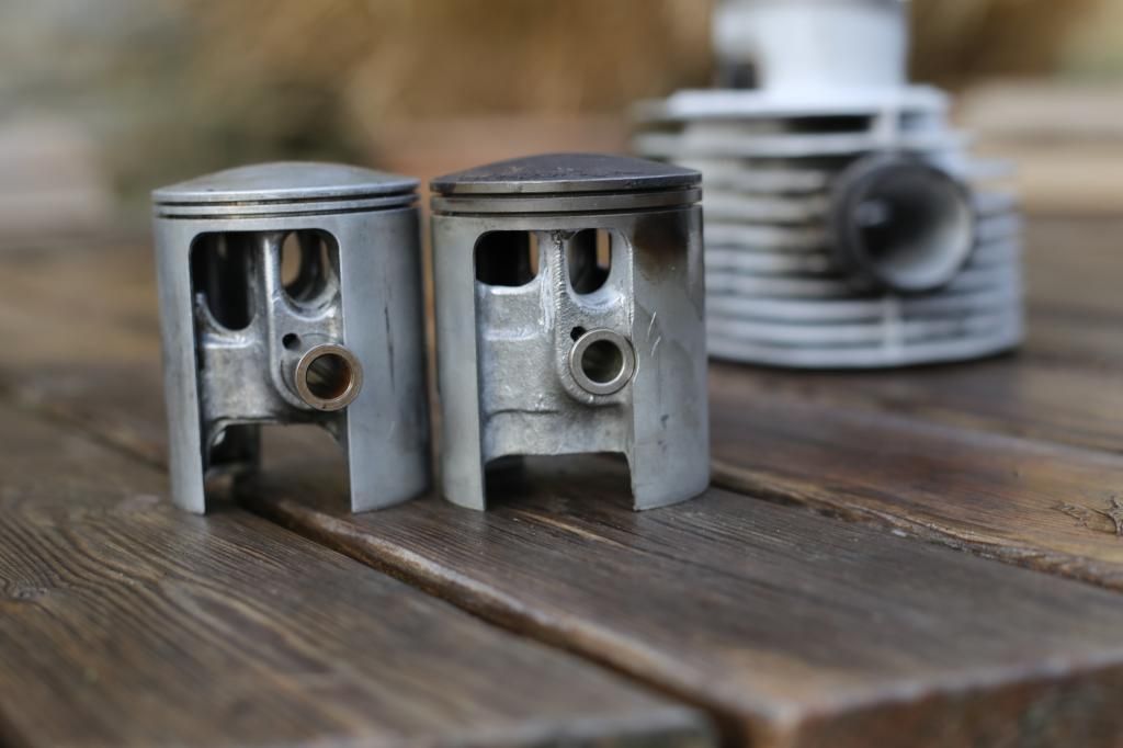

The first two photos show the piston. the one on the left hand side is the one that goes with the kit I bought a few years back and shows that the transfer has been elongated. The one on the right is the one just back from the tuners who has smoothed the transfers.
And this is the other side of the pistons

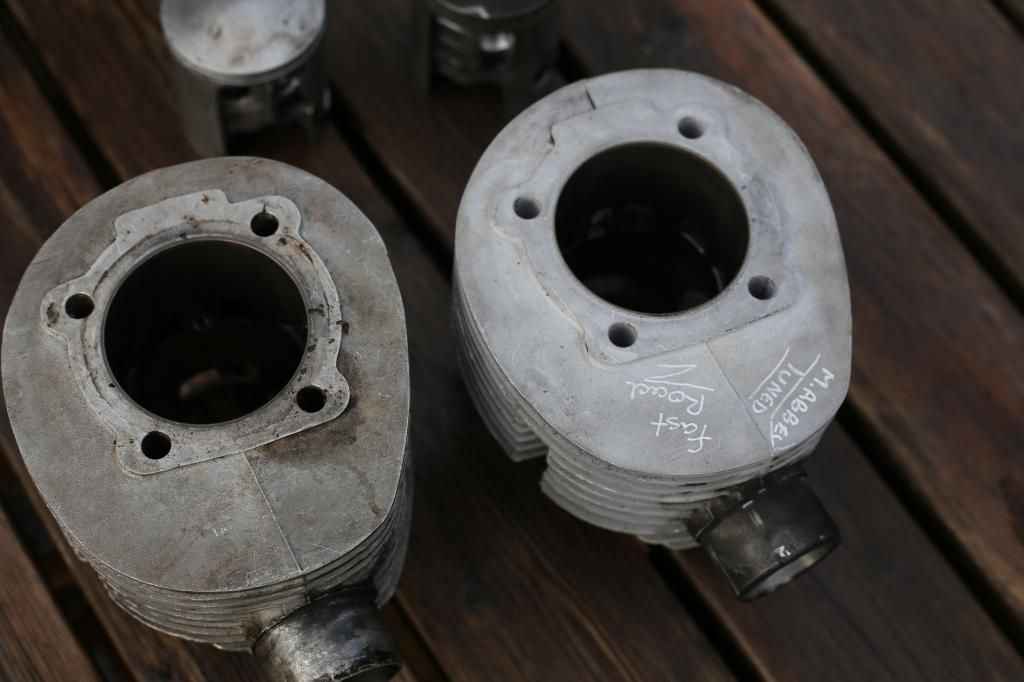

Th barrel on the RH side is the one that I have just got back. The change to this barrel is to smooth the ports and adjust the exhaust port. So for this new tweak, the top of the exuast port is 32mm from the top of the cylinder and 56.5 to the bottom and is 46mm wide. As for the older barrel, the measurements are 32,55 and 41mm wide. In addition, the older barrel has the initials TWS

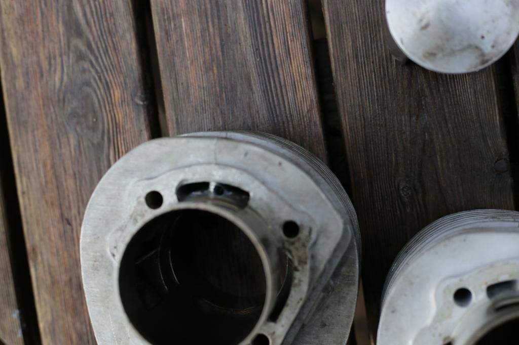

As for the other barrel ports, they all look similar in size, but with the exception of the old barrel. Here they have crudely drilled out a blanked transfer port.

the first one looks like my old Chislespeed 221 top end (60 crank) with the piston milled out and boost port drilled. went really well and pulled a standard P200E 4th gear no problem. ran it with a 30mm dellorto(non reed) and JL righthand pipe. it pulled us great 2"s up, redheed (the wife)wasn't pleased when I sold it. I should have kept it and and put my EFL gearbox in and disc brake on, would have been a cracking scoot. at the time we were always 2"s up, so we went for a standard 200 for the bulletproofness...(invented new word....... :lol: ) try both... see what you like.....

this drilled hole in the boost port m8.
what size is it ?

As for the older kit, I will have a go with it on another Rally200 engine that I have in a GS160. Finally, to answer Norries question, the bridge in the transfer port has been drilled out to 4.5mm diameter.
