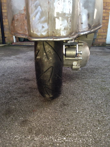

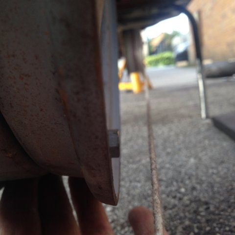

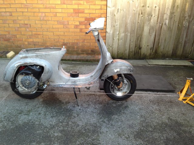

Has anyone reversed there rear PX wheel rim, where the larger part of the wheel rim is on the outside. Im still trying to get the front disc set up on my GS to line up. When I reverse the wheel rim it lines up perfect, so Im hoping I can get away with this. Its the rear wheel rim Im reversing.

When I reversed the rim the alignment is near perfect, so I am happy with the alignment. The disc front end is supposed to be for a rally/sprint but it does fit the GS150 forks, I have also tried the rally forks and it still throws the alignment out, turning the rim around is the only thing thats worked. I can make the engine bracket to move the whole engine so the wheels align, but this leads to other complications.
