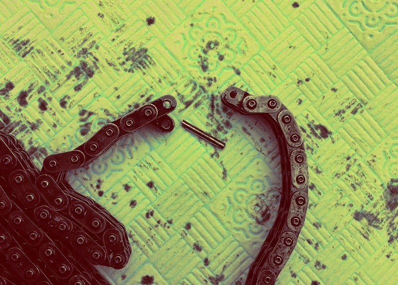

Had the side casing off friday on the 225 engine and had a wee look round and found this..
The chain looked ok on the sprockets and while having a quick look over it I saw the pin half out.

I found exactly the same in a mate's iron 230 that I stripped, with the split pin on the magnetic drain plug and nothing fixing the link pin in place, which could have worked out at any time.
