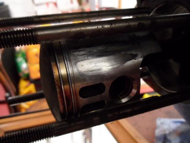

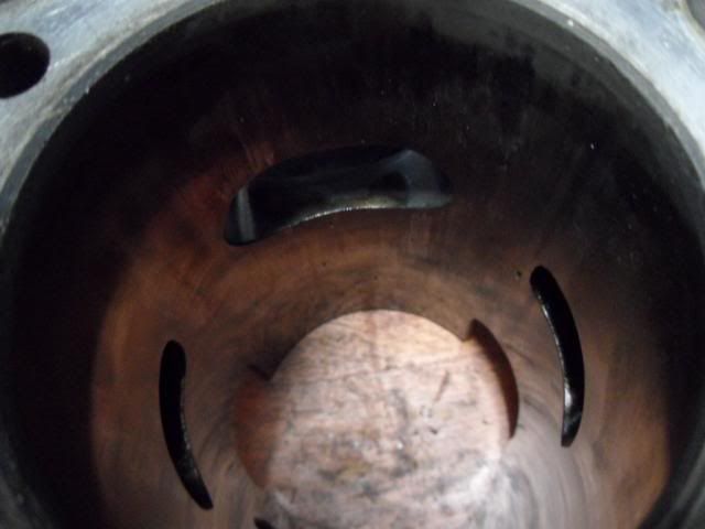

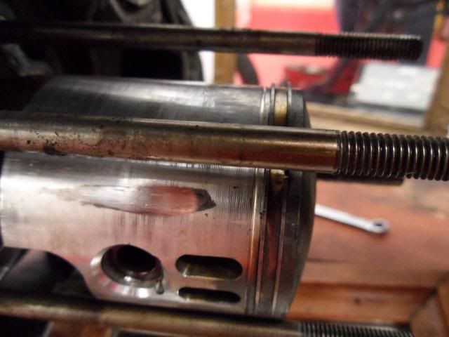

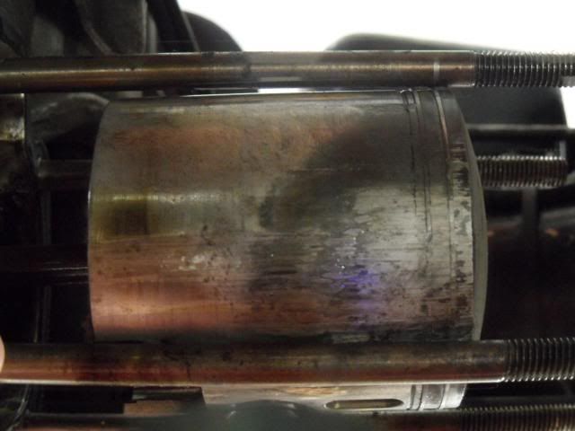

Running in a 68 Racetour piston in a rebored barrel. Piston and barrel were matched. Done about 450 miles and was riding back from Coventry 45/48 mph max. Was on a dual carriage way when I lost power and engine cut out. I knew I had lost compression from the kick start and guessed it was probably the rings and sure enough the bottom of the rings appear "welded" in :o Barrel look ok ish. Plug colour is ok. Any thoughts why this has happened? Is the very expensive piston recoverable? Please be gentle... :roll:

Speed you were doing is to a certain extent irrelevant. Were you varying throttle opening / speed or sitting at a constant speed? Coasting downhill on a partially open throttle? Did you have a full tank or near reserve? What carb and what float valve?

Yes varying throttle, and had filled up 15/20 miles earlier (crap petrol?) Using mineral oil which I poured on top of the petrol. Would it have mixed? Was doing a constant speed for 5-10 miles as was on dual carriage way. Not coasting and didn't go over half/two thirds throttle. Newish 26 delly.

whats in the carb jet/slide wise ?

108 main, needle is 2nd notch. Can't remember the rest but can look. Is the piston completely fecked?

I put in 4.8 litres into a 11.5 litre tank so would have thought it would have mixed ok... :oops:
speedy
Posts: 445
Joined: Thu Jun 20, 2013 10:10 pm
