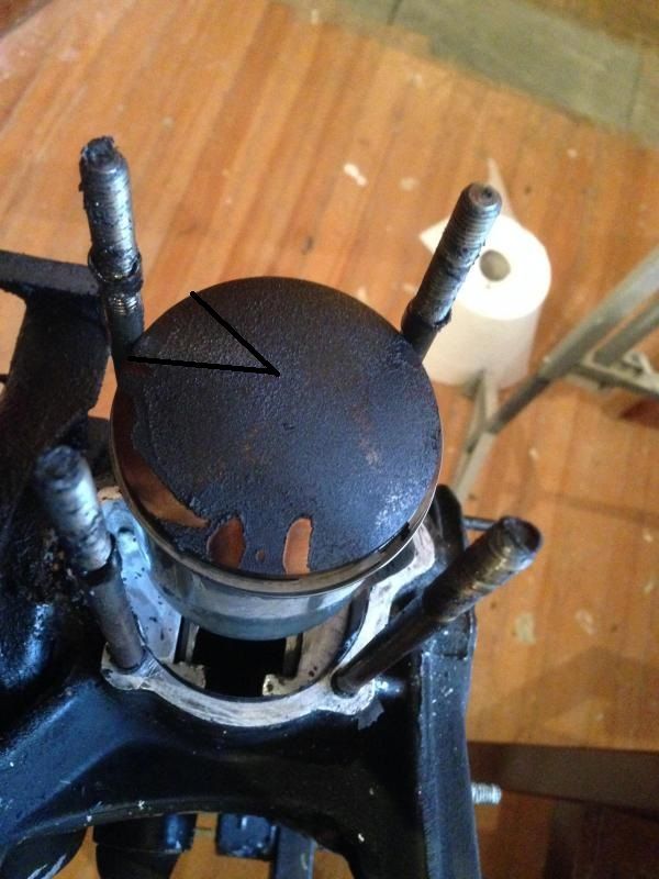

Here's some picks of the top end, the head is just as I removed it, completely spotless :shock: Never had that before :? The bore seems ok with a just discernible wear ridge at the top (I ran it unfiltered for the first 1000 or so miles) and some slight wear on the exhaust bridge but otherwise great. I haven't measured the ring gap but you can see that it has just started to blow by the top one.

unsymetrical combustion son!

fastfrog wrote:unsymetrical combustion son!
I was wondering about that, I thought the swirl marks from the transfers would be on both sides :? I should point out that the fuel consumption has always been on the high side (32 mpg best recorded) so any thoughts along those lines would be appreciated.
How can you tell?

The flow patterns that show themselves in the carbon deposits on the piston crown.

half bat print on top of the piston

Yep, crown patterns can easily differ from side to side and, whilst perhaps not the 'pattern' that you might wish for, the most important factor is how the motor performs.

fastfrog wrote:half bat print on top of the piston
Please explain more, is it bad or good, us mere mortals are trying to learn :?
