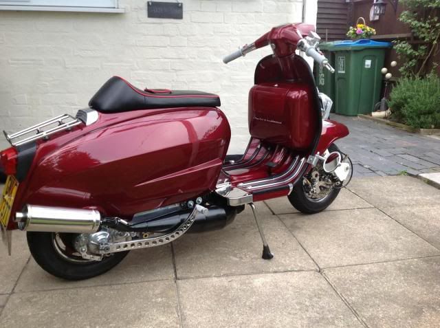

Anyone running a SSC taffy copy pipe?

Could you take and post a pic of how you have the rear bracket set up? I want to make sure i fit it correctly. :oops:

And does your centre stand foul on it like mine?

i`m in the garage tomorrow so i get a picture
i have 3 they all catch the stand to varying degree when i fitted them
one required just a shave of the stand foot and the the othes a bend on the stand but not much
gaz

I think the stand needs a bend alright, cheers in advance for the pic!

pm your email and I`ll fwd the close up pictures if you still need them
they are not great as the brackets are coated black but you should get the gist

Had one on my old gp the only issue I had was crappy tail can mecarno bracket that I took to work and modified myself plus bought a bracket from scooter loopy john

Does this thing clear rear footboard on a series 3???

the most recent one I fitted a stainless one to a full panelled gp - I only had to take a scoop out the back of the runner (as most expansion pipes)
funnily enough that one never fouled the stand
regarding the rear bracket I alter them and add a rubber bobbin - done loads of miles on a stainless and mild steel one
