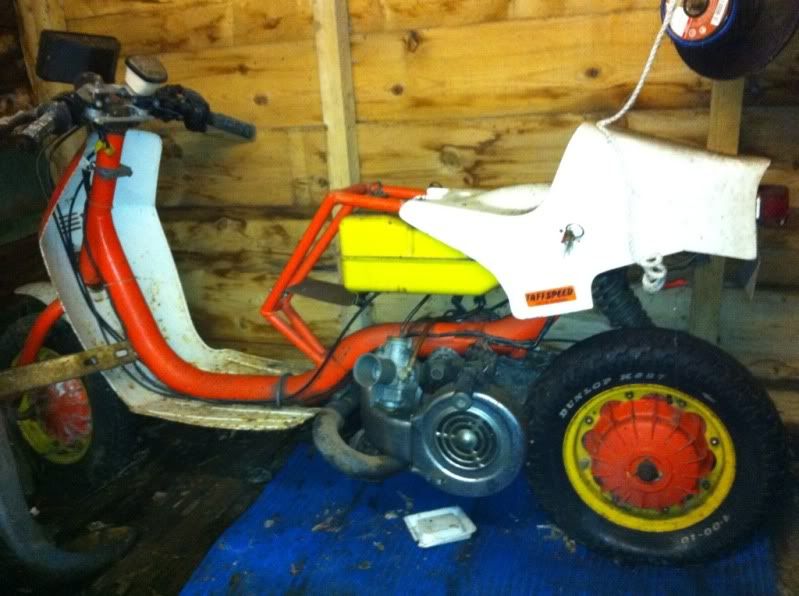

Well here is my other lammy .built it in 86 on dole money took over a year to save money for bits .
Engine is a 185 stage 5 taffspeed with atac power valve
Beedspeed drops , quick action throttle
Taffspeed rear set brakes
Shortened headset to match the vega legshields
Mickek exhaust
Already cut down frame when I got it so removed the loop and made the frame to suit
Fibreglass back end and star stream tank if I remember correctly .
It's sat idle for a good few years but hopefully get some love when I have some spare time .
Cheers Steve

I like that mate :D what's an Atac power valve ?
think he means the little chambre things that were popular on late 80's street race scoots
Hi
As ric speed mentioned they were popular in the mid 80s .
It's a adjustable valve that was welded to the u bend and help acceleration through the rev range depending on where you had a screw on top adjusted .
Taffspeed built motor in 86 and were something they were using at the time on some engines .
Hope that helps ?
Cheers Steve
