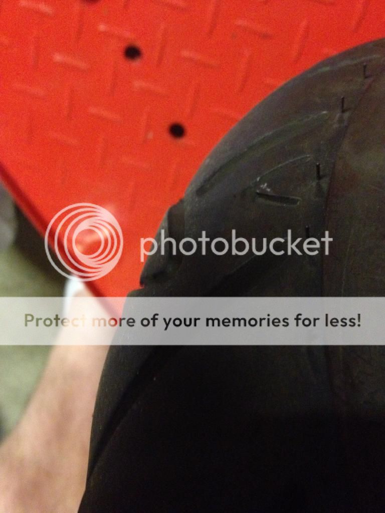

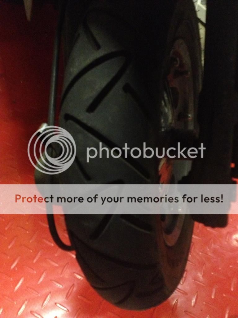

Have uploaded some pics .... so you can see what im on about.. they are wearing on the inside of the curve of the tread

Too stiff fork springs and dampers can cause your front wheel to "bounce around" and cause that sort of uneven wear. Also if you don't have balanced suspension ie an original shagged out rear shock coupled with updated front.
