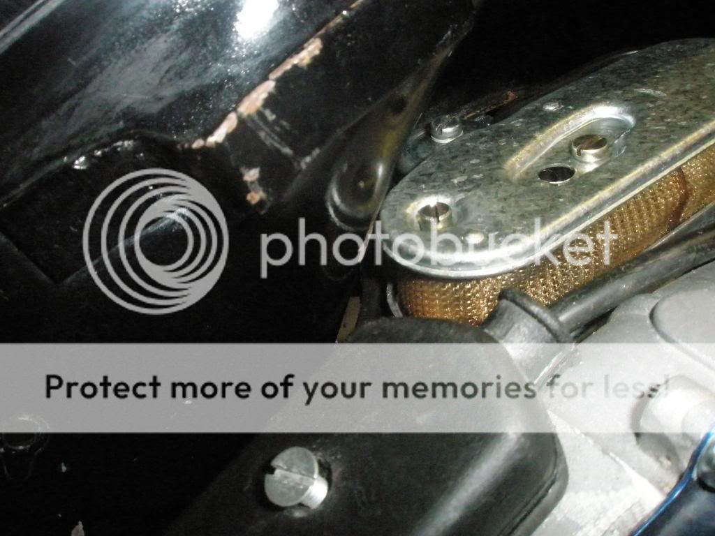

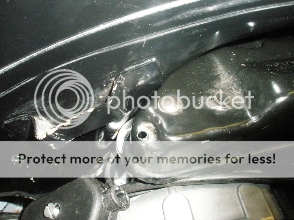

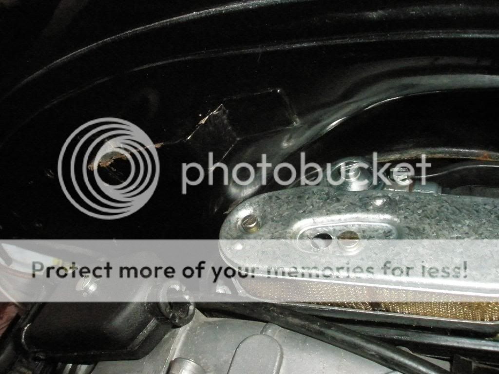

Managed to squeeze the engine in tonight but now have problems with the carb hitting the frame. The filter just touches the frame but there is no way the cover will fit. See pics. Any suggestions?

ducksta
Posts: 1129
take airbox off and hit it with a hammer :lol:

ducksta
Posts: 1129
take airbox off and cut the corner and reweld at a 45 degree
