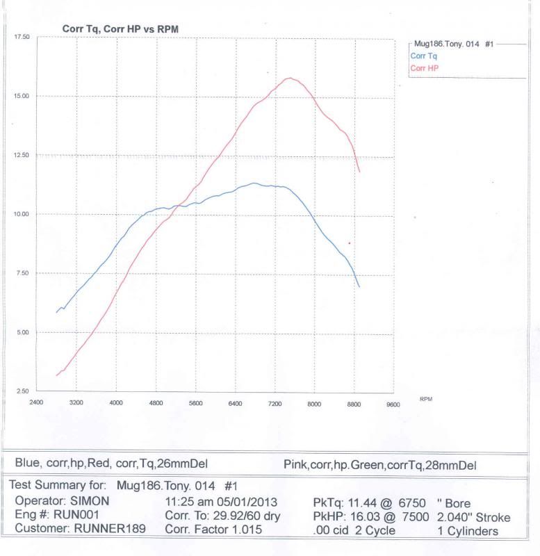

had this one saved on file and started with it, but it didn't really work for me. ( Im running a PM pipe but should get you in the region for plug chops
28phbh
55 Pilot
45 slide
AV266
X7 needle (2nd clip)
115 main
after the dyno it was this
28phbh mugello with PM expansion
40 slide, 70 choke, 108 main, 55pilot, AV266. X2 needle 2nd clip from top. mixture 1 3/4 out from lightly seated
did this on the dyno
but fitted a 26mm and gained 1 more tq and 1.25 bhp at slightly lower revs
in my setup it pulls quite well, and I have had long periods of WOT with no problems, obviously every engine is different and you should double check and plug chop etc
