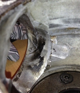

Hi all, have just stripped my crank to do the bearings and found this........
Is it important...... And does it need to be fixed?
It's a small piece of the case where the crank webs sit.

A better photo showing where the small bit should go

Im sure I have read on here some were about removing these bits of casing to detrimentle effect

I've been running a scoot for about 3 1/5 years, done just short of 9k miles (wish it was more :( ), with the following mods to my casing (its something was shown by Dan on here many moons ago) scoot runs Ok, I'd just tidy the damage up and refit cylinder :)

LI150 wrote:Im sure I have read on here some were about removing these bits of casing to detrimentle effect
Ment to no detrimentle effect . ;)

Dell Oughta wrote:I've been running a scoot for about 3 1/5 years, done just short of 9k miles (wish it was more :( ), with the following mods to my casing (its something was shown by Dan on here many moons ago) scoot runs Ok, I'd just tidy the damage up and refit cylinder :)
Mike
I don't mean to nit pick but it looks like in this photo the drive side seal is in backwards.

Cheers fellas, I'm gonna clean the casing up and put it back together.

wrekkah wrote: I don't mean to nit pick but it looks like in this photo the drive side seal is in backwards.
No its not (i've been through this already)...Its just the angle of the pic ;)
