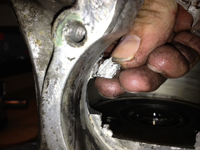

Hi all, have just stripped my crank to do the bearings and found this........
Is it important...... And does it need to be fixed?
It's a small piece of the case where the crank webs sit.

A better photo showing where the small bit should go

Im sure I have read on here some were about removing these bits of casing to detrimentle effect

I've been running a scoot for about 3 1/5 years, done just short of 9k miles (wish it was more :( ), with the following mods to my casing (its something was shown by Dan on here many moons ago) scoot runs Ok, I'd just tidy the damage up and refit cylinder :)

LI150 wrote:Im sure I have read on here some were about removing these bits of casing to detrimentle effect
Ment to no detrimentle effect . ;)

Cheers fellas, I'm gonna clean the casing up and put it back together.
