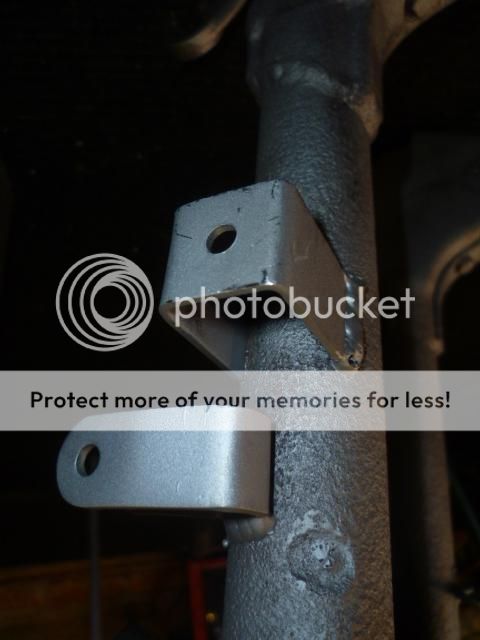

Anyone point me in the right direction on these brackets that attach the forks to each side of the turning mudguard. I think I have seen a pic somewhere and they are u-shaped peices of metal with a thread welded on to take the mudguard?
If these are still not avaialble then a pic would be good as i should be able to get something fabricated.

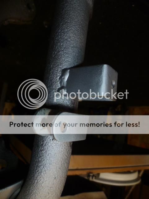

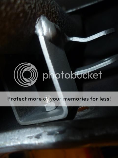

Yea, the brackets are no more fancy than a bit of U shaped metal with a hole in to put a 6mm bolt through and a nut the other side.

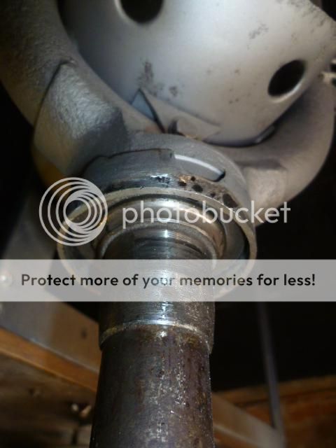

and you have to remove the dust cover on the frame for the mudguard to fit
cheers steve

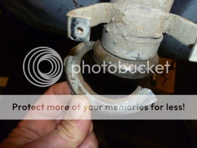

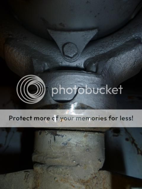

A collar will need welding to the forks for the muduard to clamp on to, as far as the side brackets are concerned, I hope this helps...
Courtesy of Cobby ;)
the collar as far as i am aware is the same section as the frame tube
sydduckett
Posts: 1900
soulsurfer wrote:A collar will need welding to the forks for the muduard to clamp on to, as far as the side brackets are concerned, I hope this helps...
Cheers for that couldnt really ask for more....... :D
