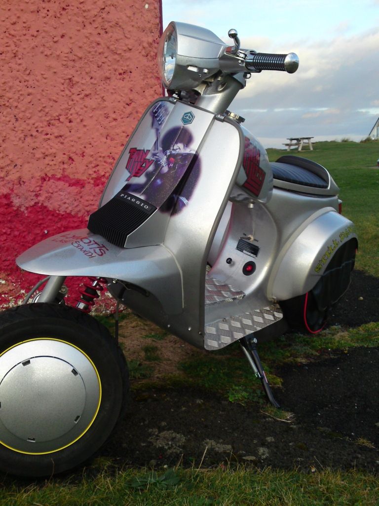

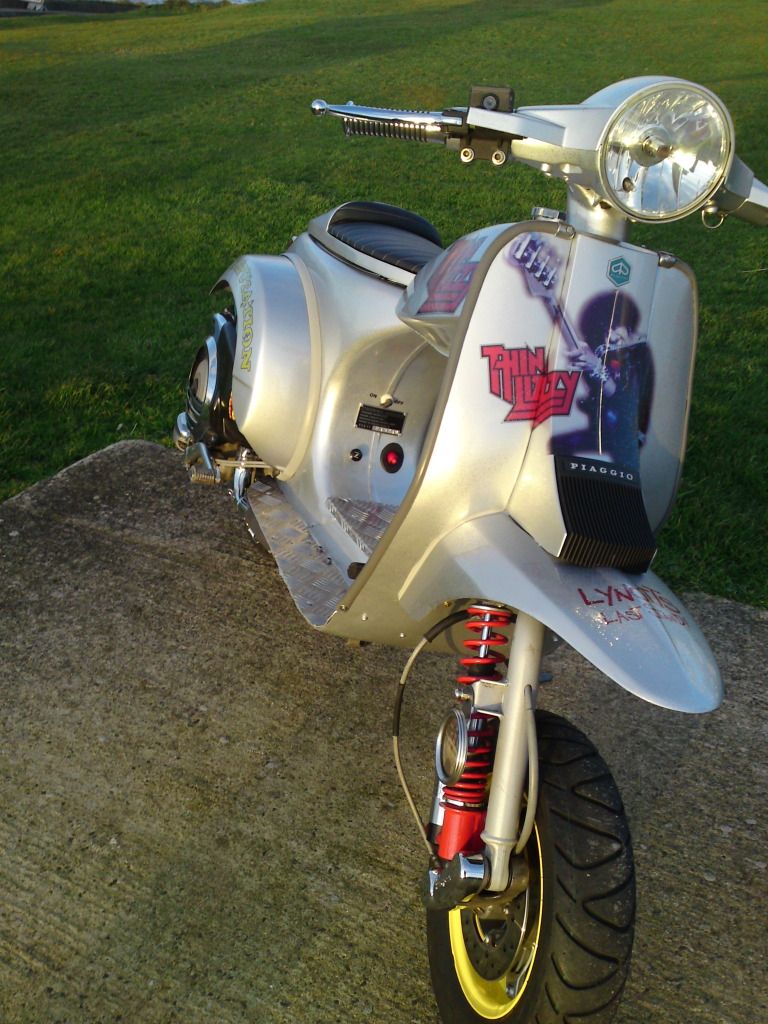

Built this over the last year from bits lying around the garage and fleabay!!!!!!!!!!!!

cool as mate, I like that alot :fb:
I like that too.

Thanx for all the positive comments,,,,,,,,,,,,,,,,,,,,,,,much appreciated :mrgreen:

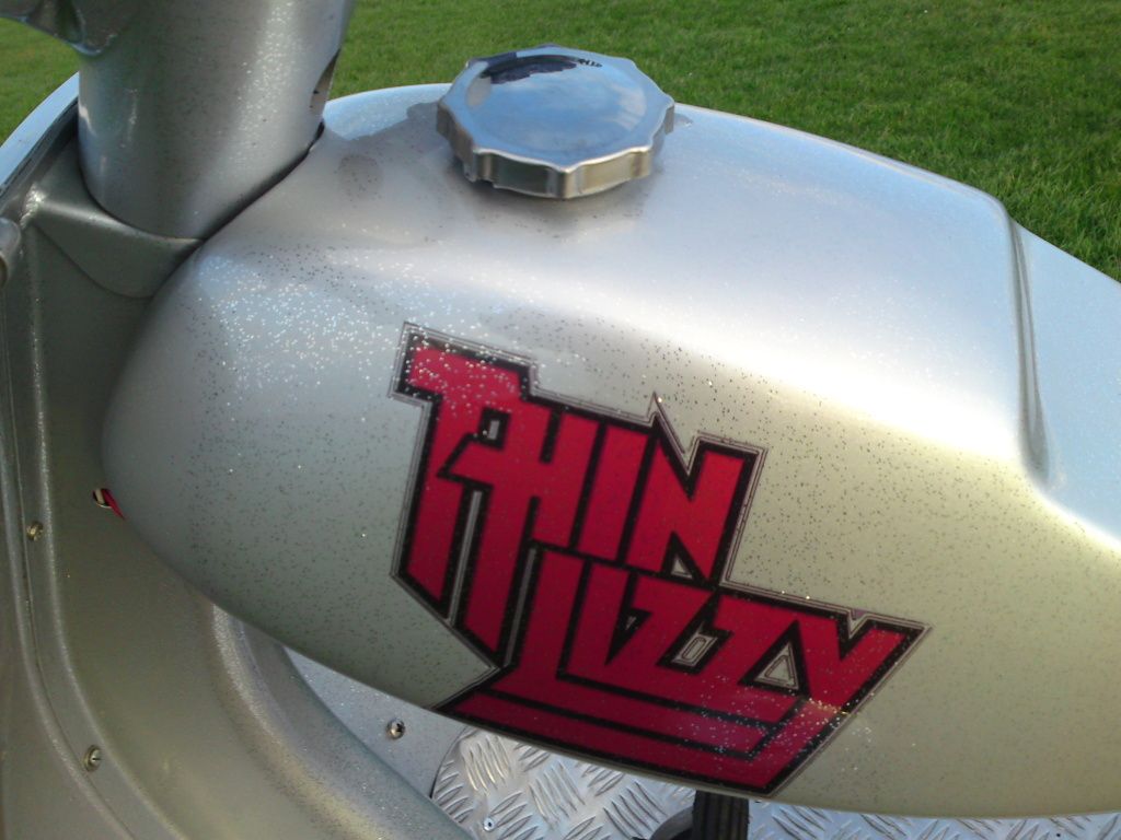

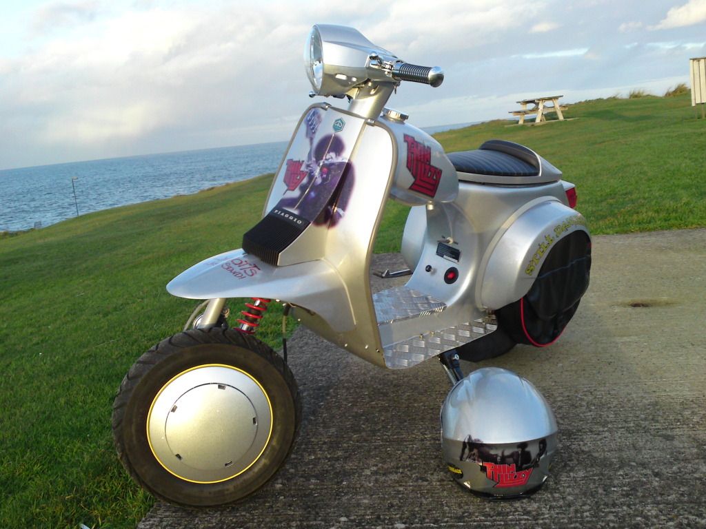

any idea what the tank is off ?? would have said puch or batavus .. you see quite a few old pics of 80's cut downs with that type tank

RICSPEED wrote:any idea what the tank is off ?? would have said puch or batavus .. you see quite a few old pics of 80's cut downs with that type tank
very nice btw :D
I,m quite sure they are of a 50cc BSA from the late 60s early 70s i have used them twice they are a perfect fit between the headset and main frame and easily hinged to access you spare, Only downside using them is they cover the key ignition positions on the EFL/DISC PXs so i have got round this by useing a remote ignition i velcro on to the blanked off indicator housing i can then snap off and put in my pocket when i park up. BTW the tanks are normally a blue metallic colour as original not to mention they are a nice shape the way they step down only my opinon but nothing worse than a scooter built around an over sized tank..........
spare wheel is a nice fit!
shamrockexpress wrote:I,m quite sure they are of a 50cc BSA from the late 60s early 70s
ahhh bsa beaver
http://motorcyclerestorations.blogspot. ... m-web.html
thanks .. i should have known really ;)
