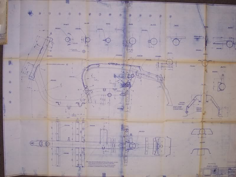

any tips for checking a frames straightness, etc, ?
just curious as i disassemble my dry built gp, before getting it sprayed?
cheers

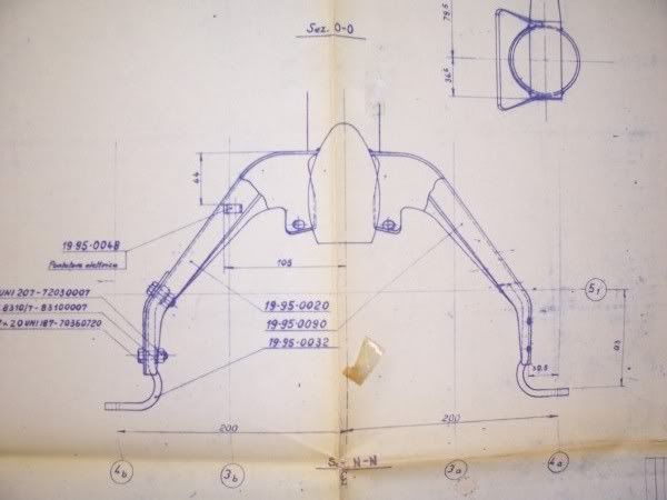

I think it was Ricspeed posted a dimensioned set of factory frame drawings some time ago. You should be able to work it out from there.
I think Wintermodel on here has his own jig.
i do have those pics yes but i dont think there's enough info on them to be of real use but i will post again no probs ,
as dapper said i'm sure in stickies book it does give basic measurements between loop and headstock ..much more than that you rely on sighting the frame a various angles .. if still not convinced its a jig mate
