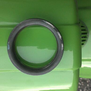

psychedelicropcircle
Posts: 525
Can someone tell me is it this piece that fits inside the chrome ring ?
Posts: 525
If so where does these go?
Thank you in advance.

dapper
Posts: 930
psychedelicropcircle wrote:If so where does these go?
That's the top steering bearing race and the bearings that sit on it before first locking ring then tabbed washer then final locking ring
lambytone
Posts: 45
Joined: Fri Jan 09, 2009 2:47 pm
This is the top race and bearing that goes into the top of the chrome ring, the other picture I can't make out, sorry.
