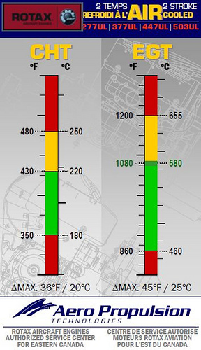

I have a Taffspeed RB250, in top at about 70mph (7000 rpm) or above it's usually about 220*c - 230*C, thermocouple on the head to a Michron 4 tacho.
Had it apart a few times over the years and all seems good, I don't think there's a lot of info on head temps, it seems those interested in temps use EGT's.
This pic was posted on here some time ago for reference.

All the experts thoughts tend to say 200c is very hot but my rb 236 regularly goes over 230 ish and hasnt gone pop, and temps depends greatly on road & wind conditions. I think some chts read higher than others. If u look at the rotax chart in the above post it shows 250c as acceptable. But its all about knowing ur own engines speeds and temps. Get out and ride it then u will discover how it runs and what temp speeds it can do.

I should clarify that my T/C is fitted under the plug rather than fixed to a fin on the head, I would imagine that this would make a significant difference to the result.
