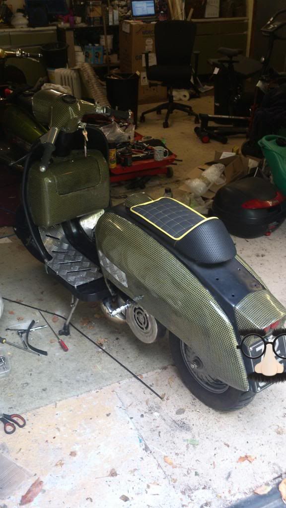

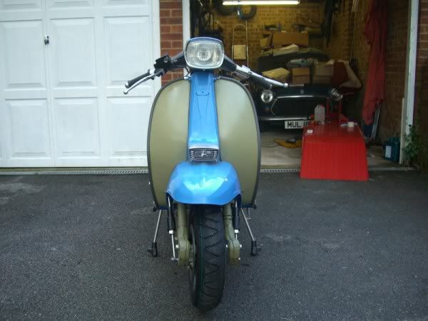

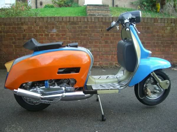

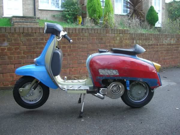

Finally finished the Kevlarmbretta (named by a friend I hasten to add !)
Transformed from this :
To this:
Hope you like it !!!

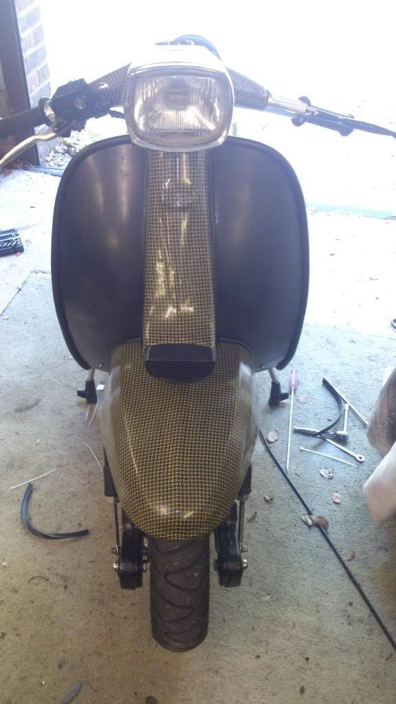

Has Kevlar been used or is it just an effect ? Any other info' on scooter spec' ?
KCB
Posts: 80
Joined: Fri Mar 13, 2009 4:31 pm
Kevlar material over the steel then coated with epoxy resin.
It's a process called skinning.
I saw a carbon fibre skinning kit and decided to give it a go with a kevlar effect instead.
I bought the parts separately and it cost approx. £200 to do the bits plus £120 for the black powder coating.
The frame, tank etc I bought of eBay for £300 and the panel work for £100.
The Imola engine I had in another GP (which I upgraded to an RB22).
So if you don't count the engine the scooter has been built for approx £800.
I think that's not too bad considering how much Lambrettas cost these days
