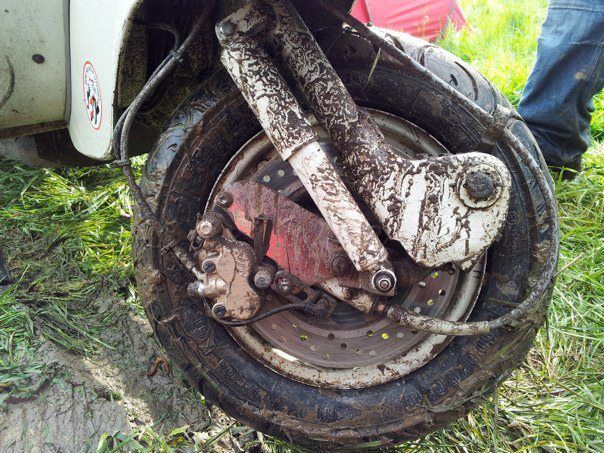

Heres mine fitted it last week. and still covered in some northern french mud :D ive just put two magnets on by the disk bolts, i put a blob of loctite just to make sure they didnt fly off ;)

Thanks all. Looks like I'll finally have to get a disc fitted up front. Don't suppose anyone out there has fitted one to a drum set up using a simple bracket?
