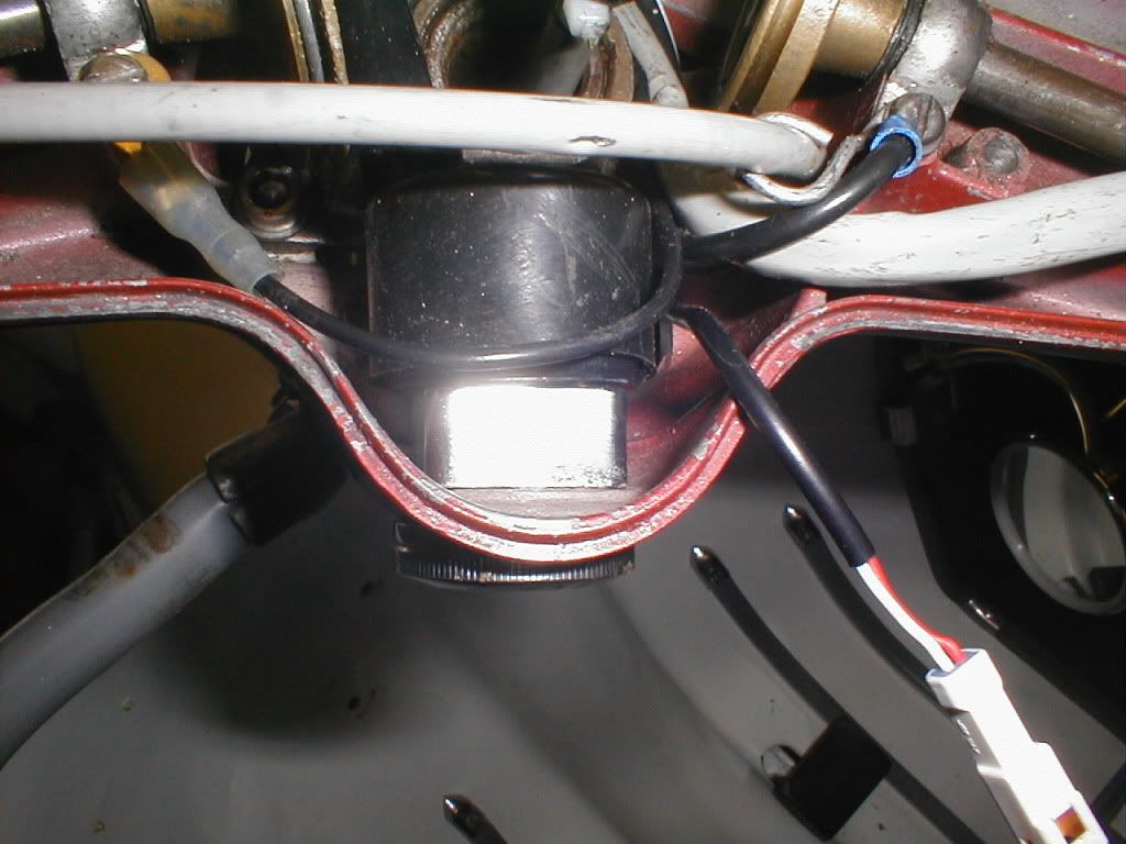

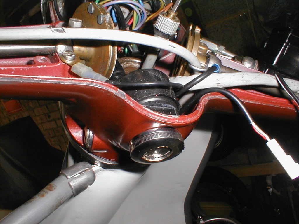

Mike, the F004 on Corrado's site is supposed to be a direct replacement, although they've been out of stock for a while and I managed to get one on ebay (albeit a tad gnarled as the guy tried to install it with Stilsons.soulsurfer wrote:Are any of the above switches a direct replacement for the kill switch or does the aperture require opening up to fit the switch through?
No filing involved here
I took a couple of photos as I've got the headset off to fit a SIP speedo.
