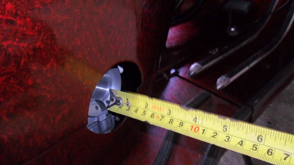

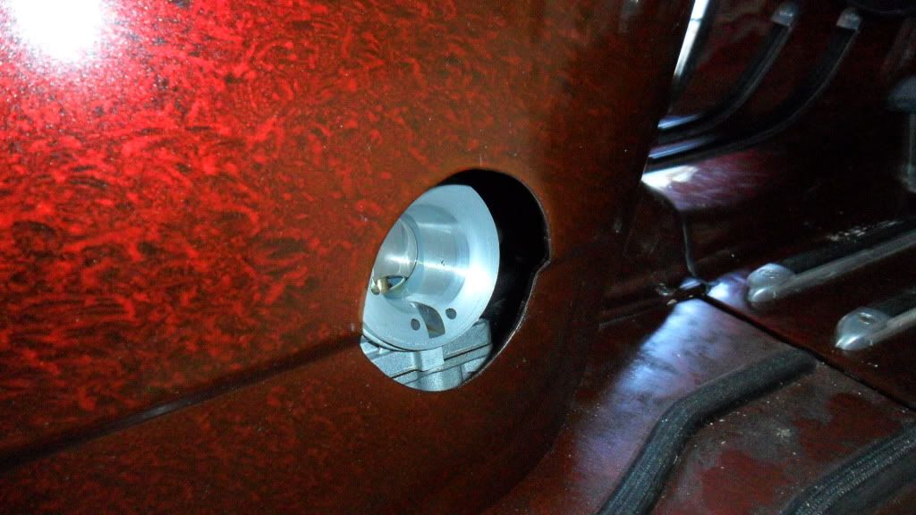

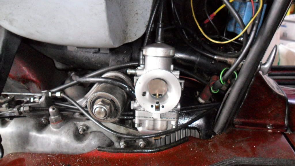

leigh
Posts: 193
Location: Dorset
Took some pics hope they help.
some with LI style panels and also one with a GP
