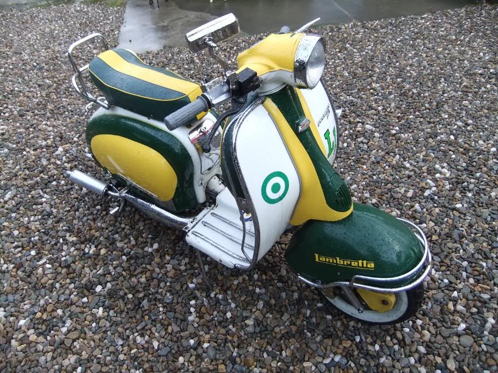

Doing this series 2 for one of my club mates. It`s an Italian Li2 which was given a Spanish front end last time round and is now getting a Rallymaster style paint job with a twist.
Here it is before I started, clean but looking rough round the edges.

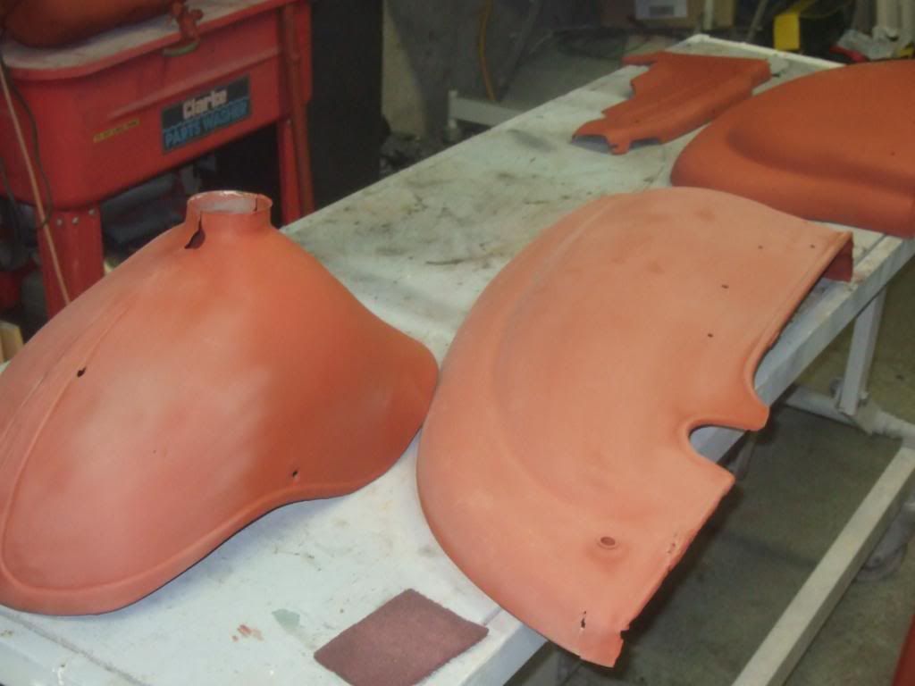

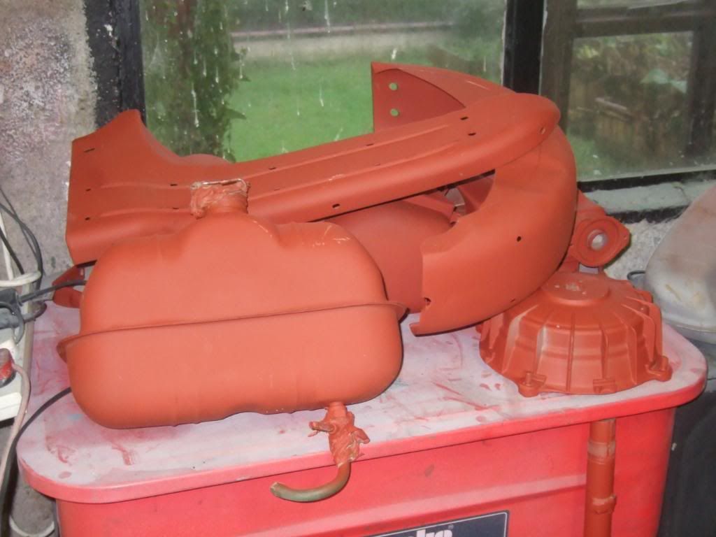

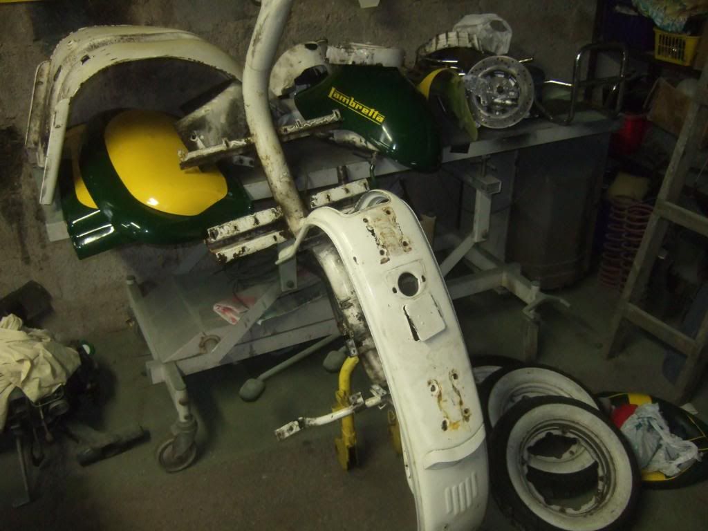

So it was stripped down and sent to the blasters.

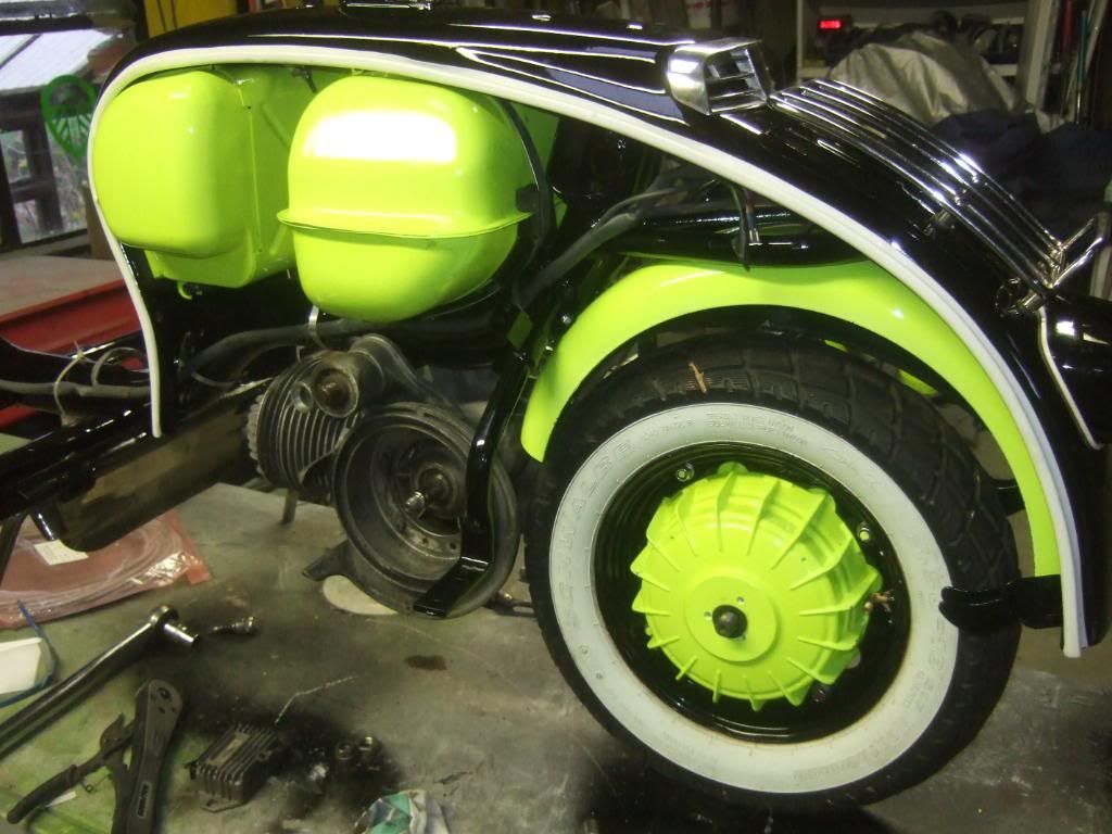

Build under way. It`ll have an alloy 200 smallblock kit, 22mm and AF Clubman. Front hydraulic disc, R6 rear shock.

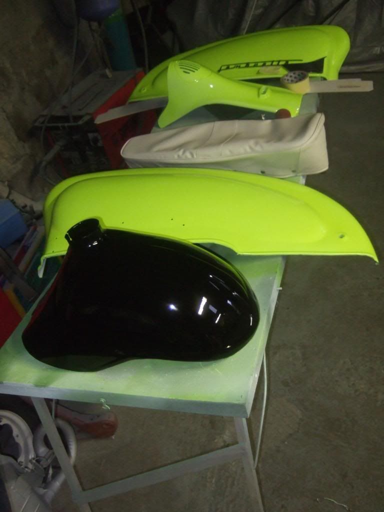

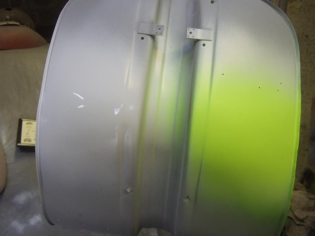

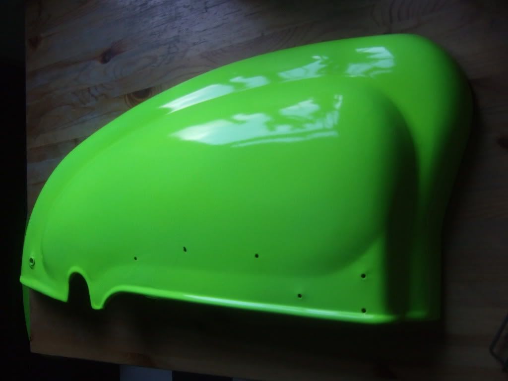

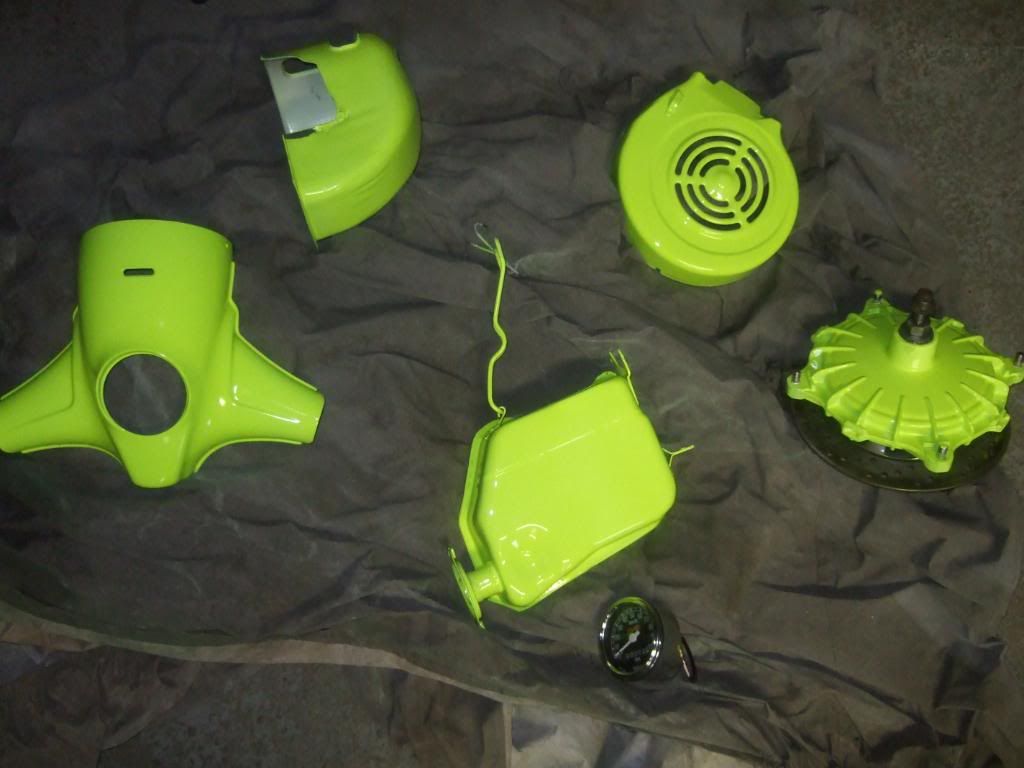

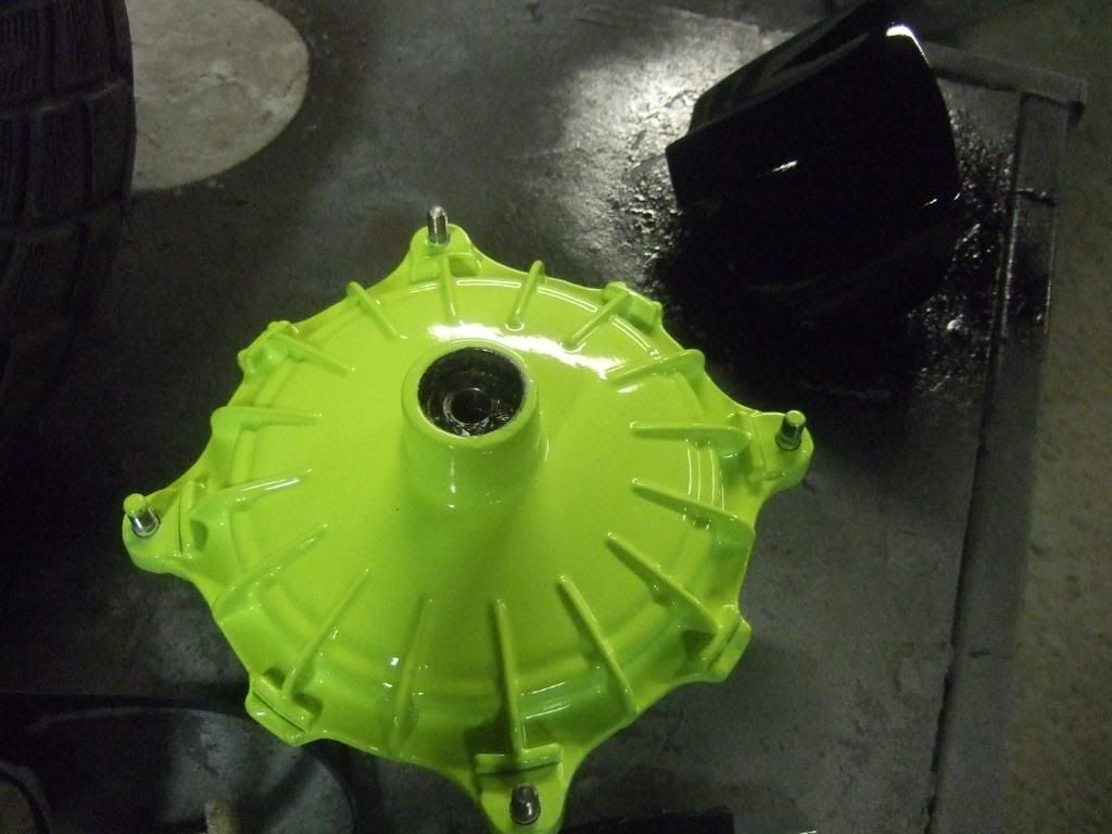

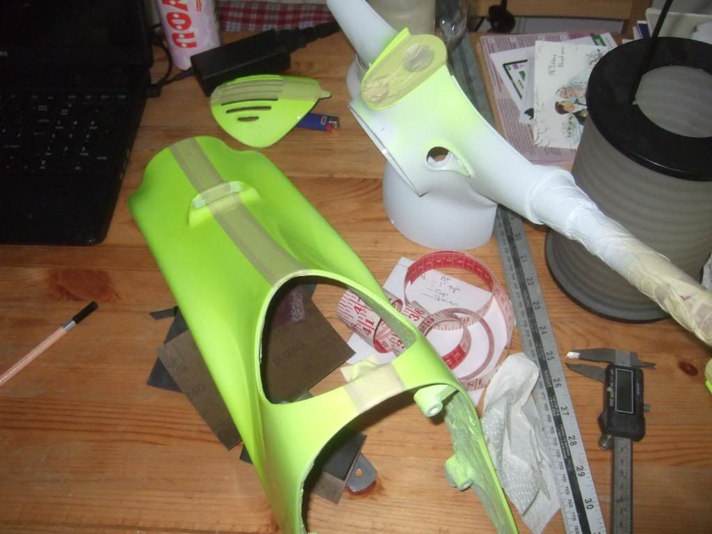

Some of the bits painted. He wanted flourescent yellow and black. The Leeds Utd away rig.
Bit of a pain cos the yellow bits need painted white, then the yellow, then laquered to preserve it but came out well.

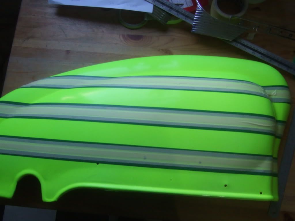

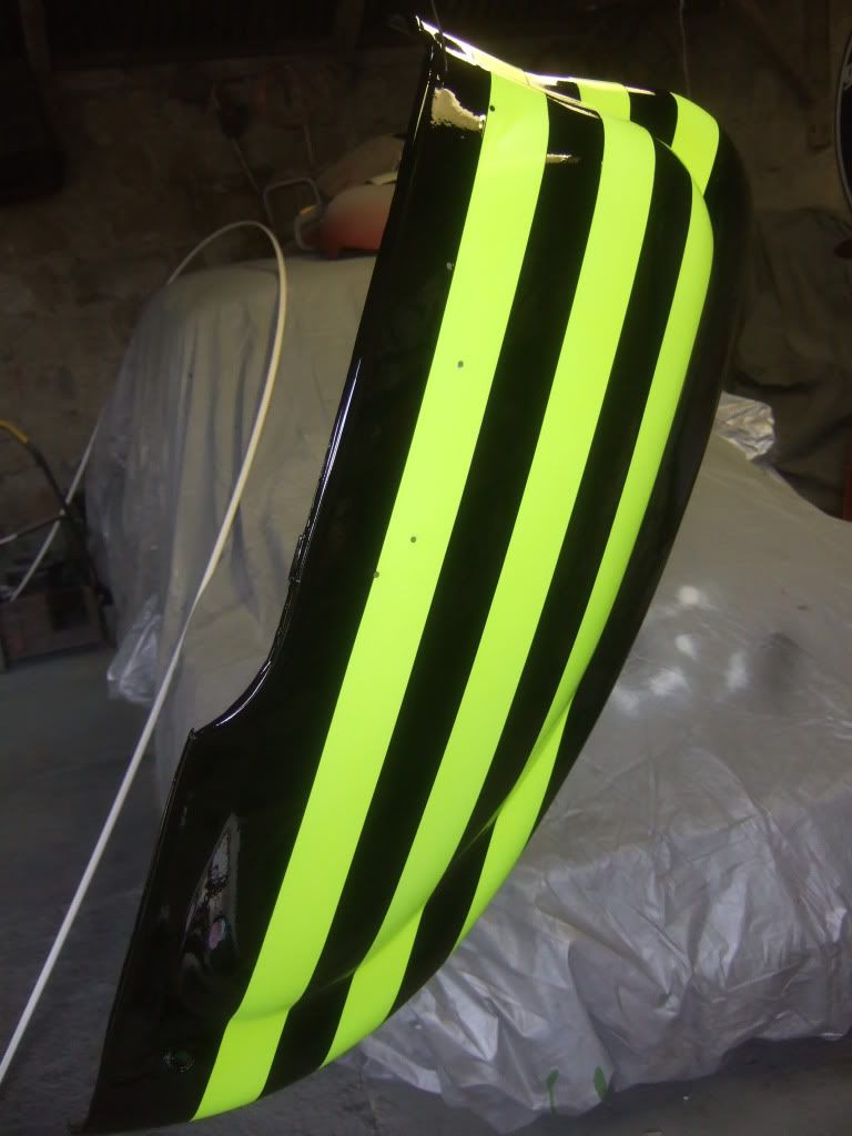

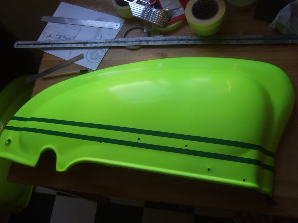

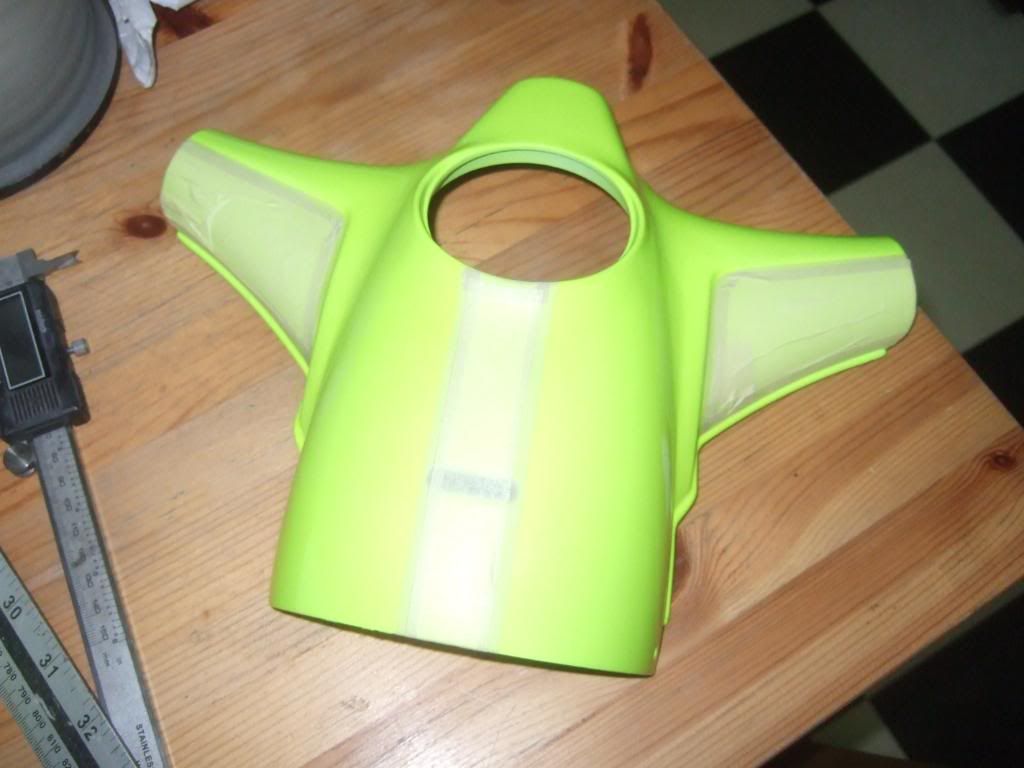

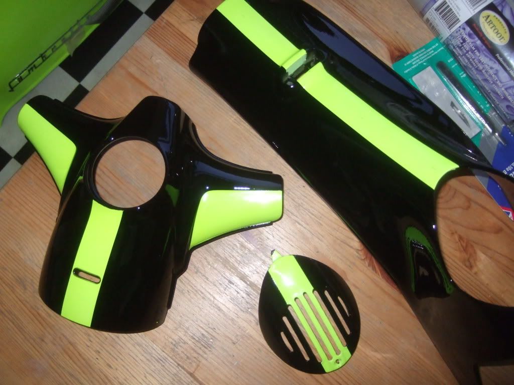

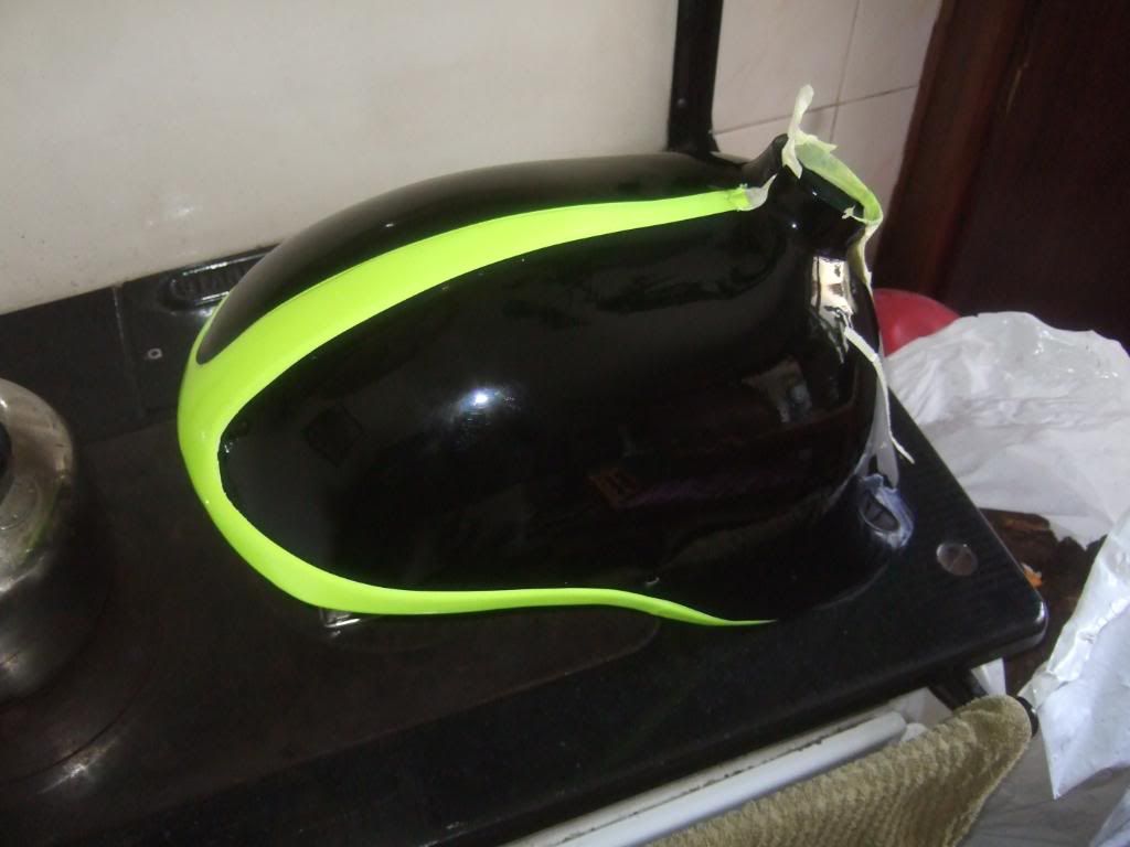

Then it was stripe and mask time
Just painted the black on the panels today in a rallymaster stylee.

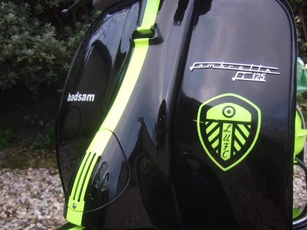

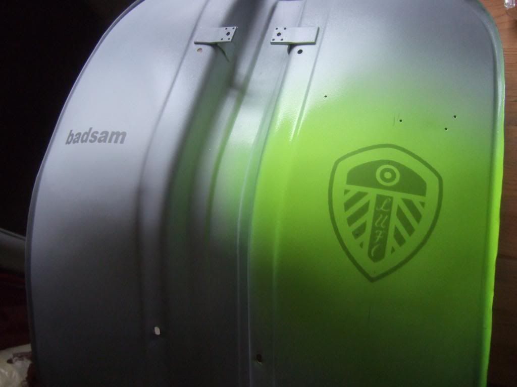

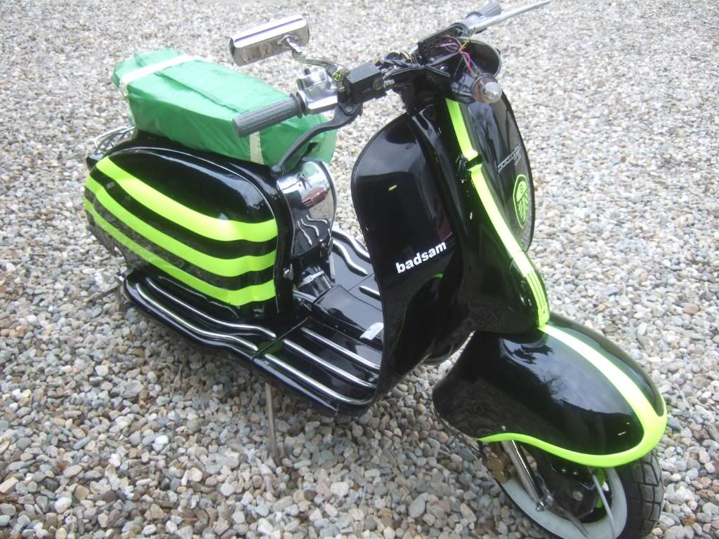

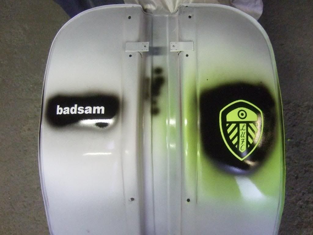

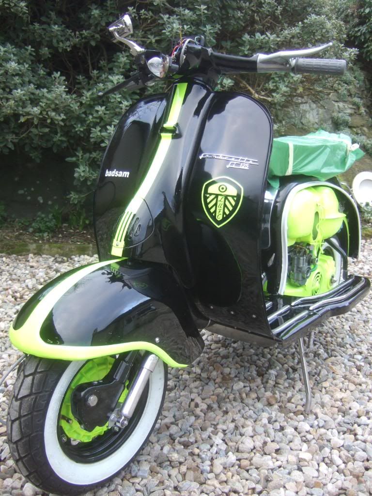

Cheers folks, getting there now. Thought I`d try out the airbrush I got as a pressy a while back so got myself a vinyl plotter and scanned the Leeds crest and made up some stencils. Since it`s a mod`s scooter I dropped the rose off the badge and added the target.
Also changed the macron logo to badsam ie. Bad Samaritans SC
A real painstaking, nerve-shredding process but it worked out ok.
On the home straight at last.
Muffspeed....no muff too tuff
Bad Samaritans SC
1957 Zundapp Betta 500 Auto
It was all going so well until the badge appeared on the legshields... :biggrin:
