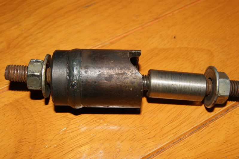

this bit i removed the one from my dragster with a socket and threaded bar and a tube on the outside ive never seen a tool to do it maybe contact cheeky thomas on the GTS forum
i uprated my dragster ones with a SOLID kit from pm tuning

As shocky said threaded bar an socket way

All sorted now . I made a tool specificly for the job and it works a treat !
