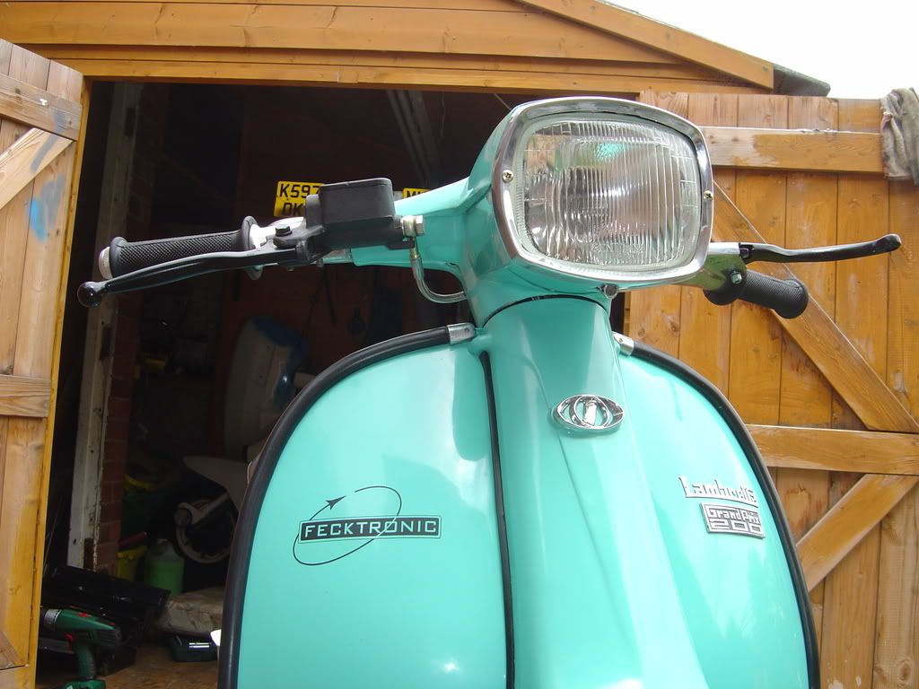

the half moon cut out were it locates needs to match you may have to take some of both parts
dont go mad thouth
were the mirror would go can be drilled through and into the switch mount i did mune 5mm then tapped it out to 6mm for a more secure fixing
the scoot rs mount has a bolt up through the bottom so you need to alter the ajp one same as the nissin one ...the speed fight unit is a neat looking alternative
