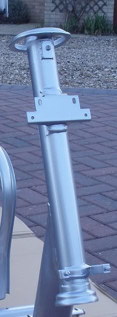

its possible you do have a series one frame ,some of the numbers on (especially 125)were well out of the numbering range given for s1's i have a frame breather 125 yet it is 59 despite the fact the rear grill was omitted by then ,but then surly then the scoot must have had a s1 horn cast also
i take it your top bracket is like this ??
mine has had the lower part of the bracket removed to fit a s2 casting
mark wrote:nice pic ;)
:oops:

RICSPEED wrote:It's possible you do have a series one frame ,some of the numbers on (especially 125)were well out of the numbering range given for s1's i have a frame breather 125 yet it is 59 despite the fact the rear grill was omitted by then ,but then surely then the scoot must have had a s1 horn cast also
i take it your top bracket is like this ?? Mine has had the lower part of the bracket removed to fit a s2 casting
Hello Ricspeed, Yeah mate that's the bracket and yes the scoot had an S1 horncasting on it when I bought it but I wasn't aware that the brackets were different due to my lack of knowledge on S1 frames - So it would seem that the factory made errors with frame stamping then, that's interesting - Thanks for that info - So all I need to do now is place a wanted add for an S1 Horncasting - Thanks - :(

not errors as such but it would seem that a number of early frames got forgotten about at the factory ,is yours(numbering wise) a late series two prior to slimstyle at all or very early?? and just out of interest is the grill area cut out or not ?
:oops:
borrowed the pic mate as an example so i could repair my bracket ;)
