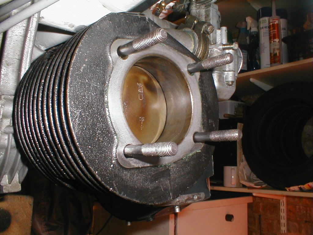

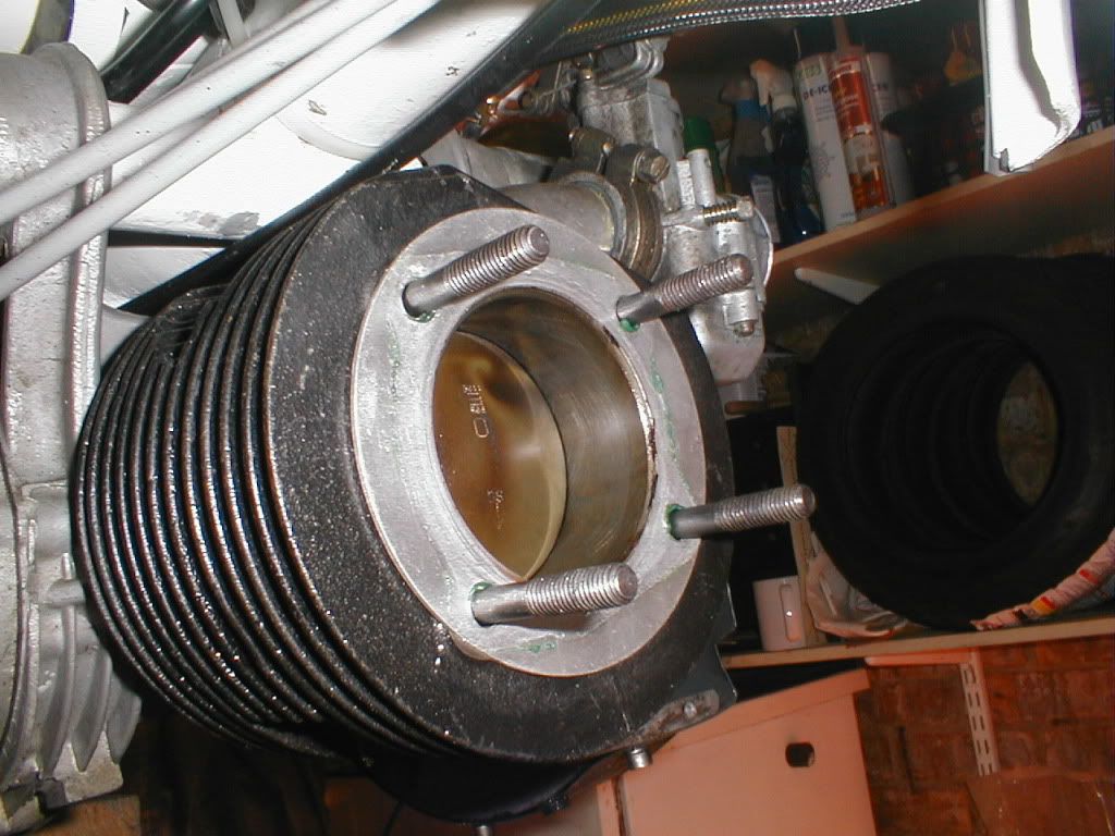

So, I bit the bullet tonight and pulled the top end apart.

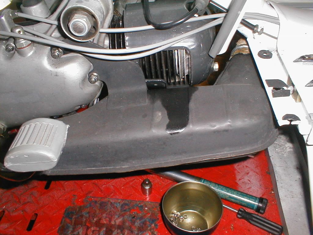

I noticed the top of the exhaust box had a streak of oil on it, right in line with the head gasket.
However, when I took the head off there was no sign of oil in the vicinity, or evidence of any burn marks (ok I've only done 20 miles, but I thought something may show.)
Next I'll examine the exhaust, inlet and base gasket, but I bet it's the mag side seal :roll:
