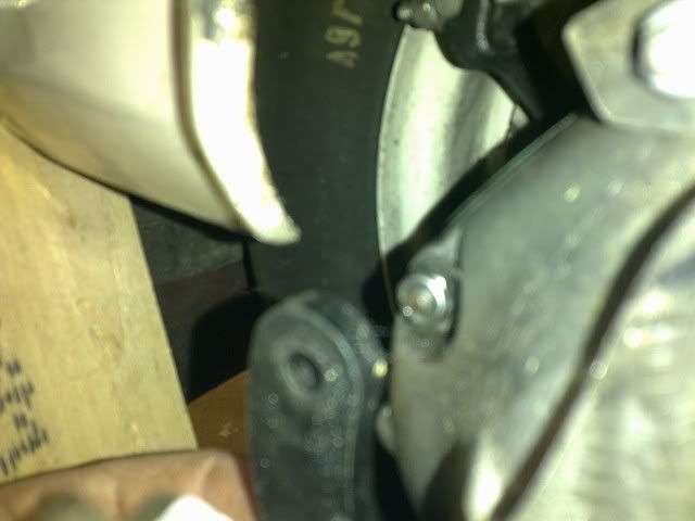

But the end can is unusually close to the panel :? make turning the panel handle difficult :roll:

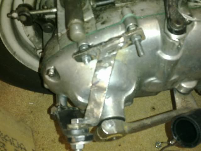

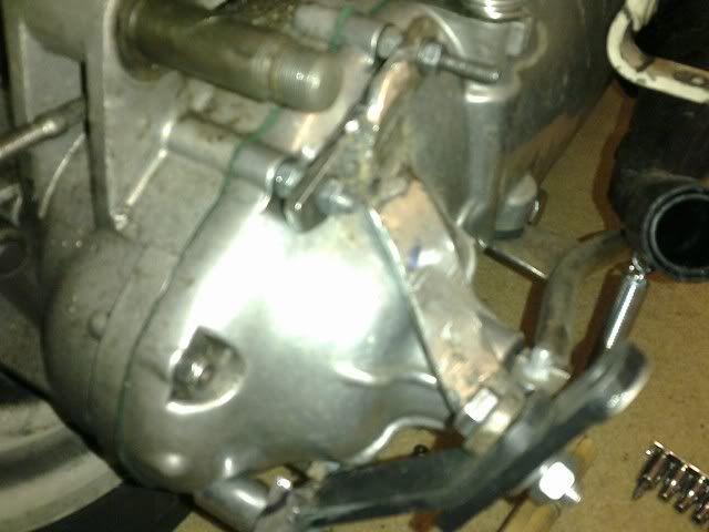

Just thought id post some pics of what i had to do ! it might help someone else
First is the part that hits the panel
The second two are the bracket i made. it would probably be ok with just the two mounting points but ive always had problems with the JL system.

carlos fandango wrote:Image
Thats a good design mate but f@@k me what have you done to it? It looks like its been ran over by a bull :-) :-) :-)
