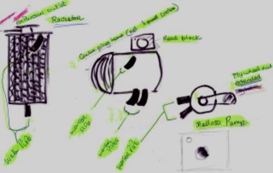

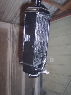

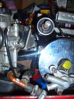

ImageImageImage just building this for my self long stroke with packing plate rd rod repegged piston and liquid cooled barrel with air cooled centre plug head would like some advice if possible there are three pipes on barrel two at the bottom and one at the top under the reed block im using a mallossi pump that is belt driven from an extended flywheel nut the pump has two pipes as well and im also using a small rad with two pipes as well as a expansion out let ive included a drawing of the set up Image im wanting help if possible as to the correct way to plumb it all in cheers just realised that i may have posted this in the wrong section if so many apologies and could it be moved to the correct section if this is the case

I have mine plumbed in as follows
bottom of rad goes to infeed on pump
outfeed of pump goes to cylinder nearest exhaust port or bottom of cylinder
outfeed from top of cylinder goes to top of rad
Thats how mines set up and it works fine :-)
