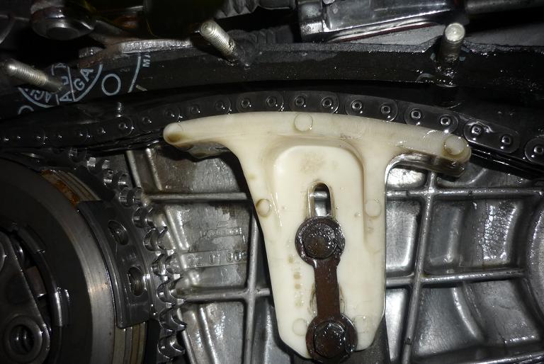

hi all! could someone tell me if this chain is too long?
I guess I must be more stretched, with no belly. no?
I hope you can understand .. and I use the google translator ..
thanks!! ;)
J1MS
Posts: 1153

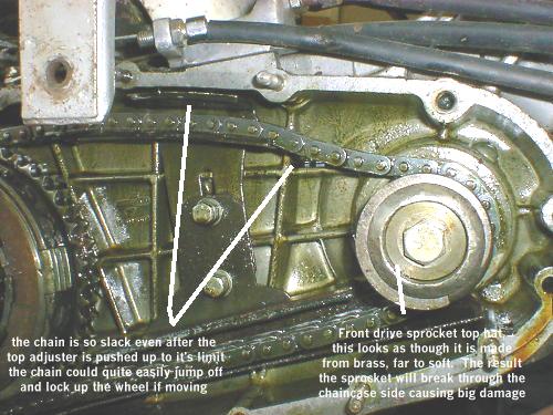

Looks a little too worn. Could do with being a little tighter, or a top down chain adjuster fitting.

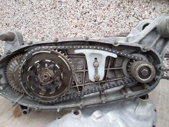

would have to be so maybe? chain .. I think my engine is way too long or too worn ..
I have 46/16 transmision
I think my chain is as in the last picture ... no?
Image :?
46/16 uses a stretched 80 link chain but I doubt it would stretch that much. It looks like your chain is too long in the first place, maybe 81 link?

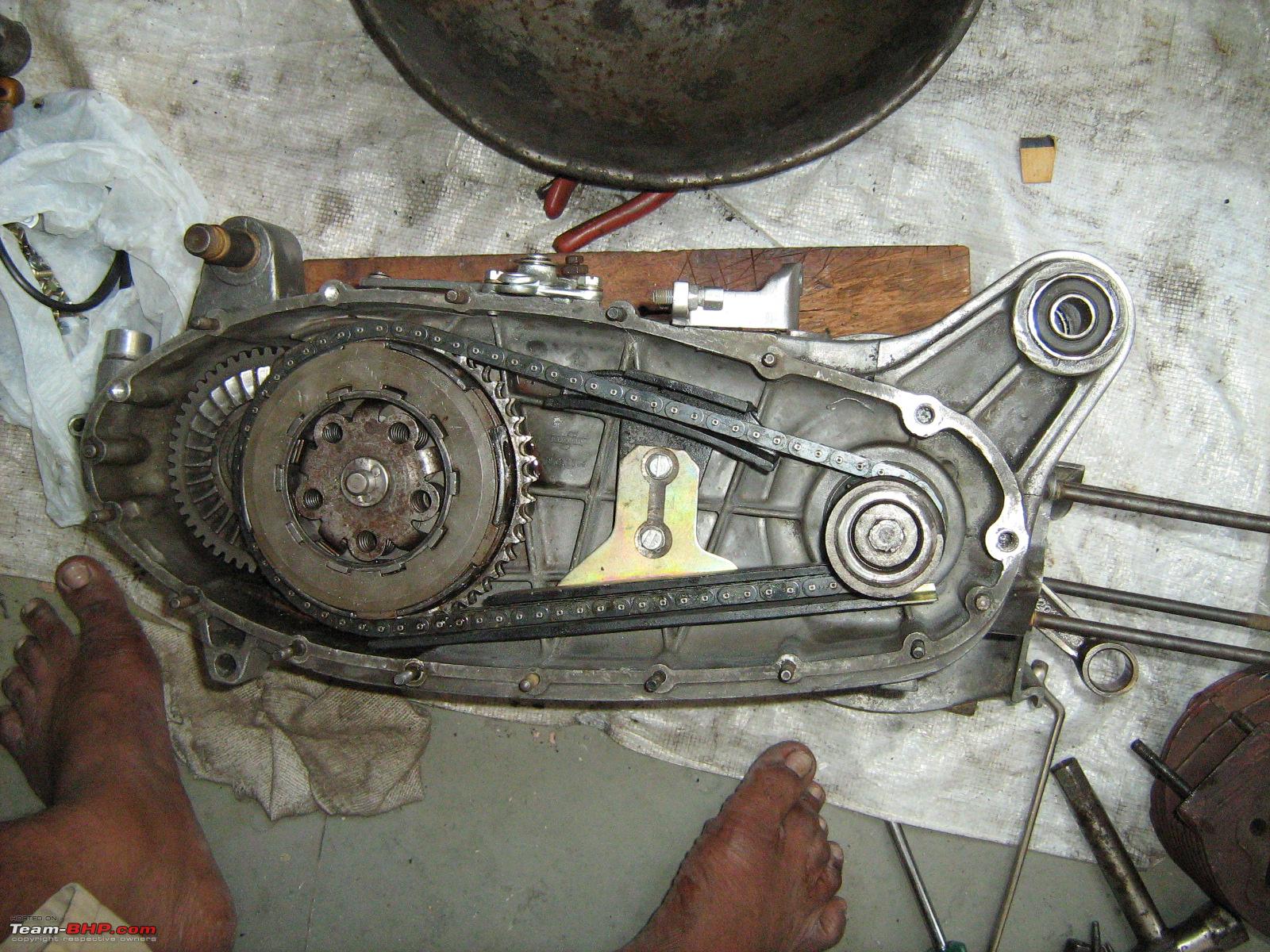

I found this picture here which shows how it is now well placed ... .. I have a question ..
tense is used only upper chain? no need to place the bottom?
some say you should ...others say not ....best fit one really
