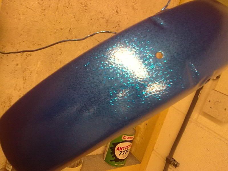

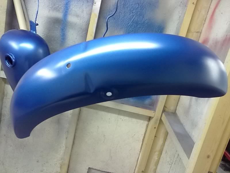

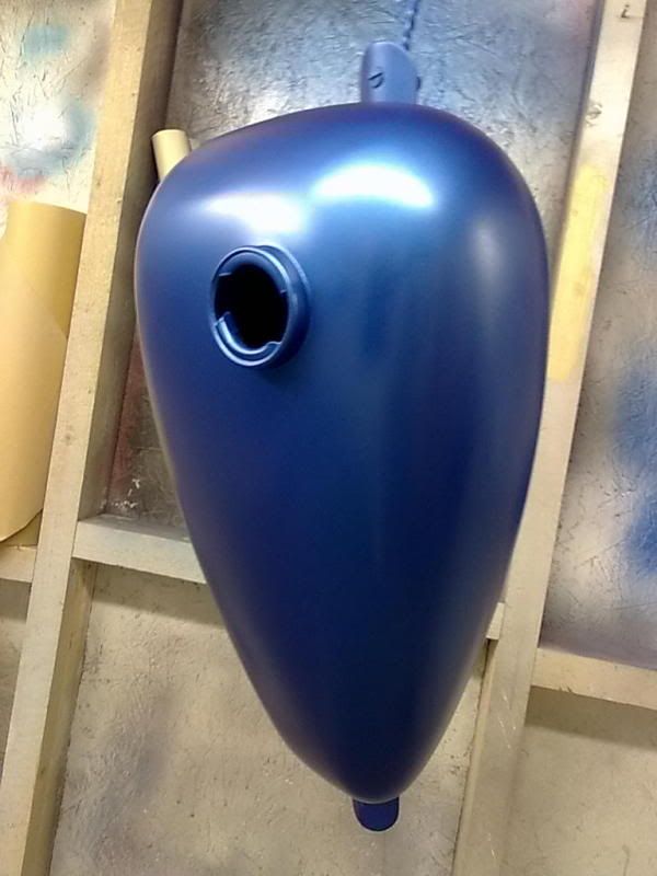

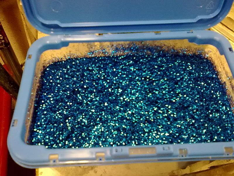

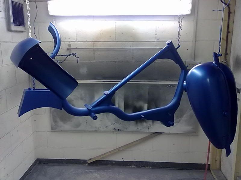

spent some time on it this week, did base in opel blue

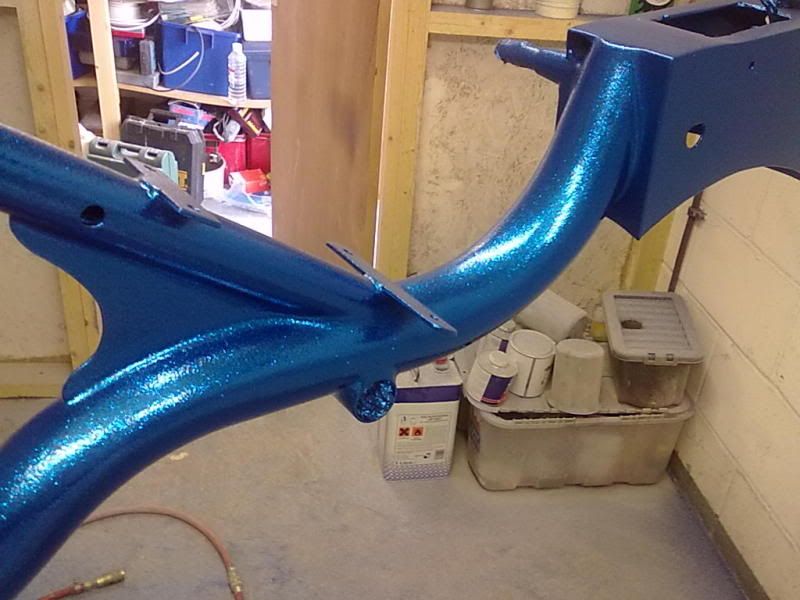

bought a load of royal blue glowble flake from metalflake in chessington
mixed with medium solids clear about 80grams per litre

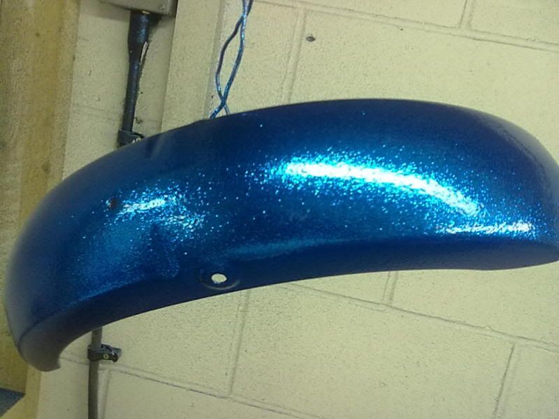

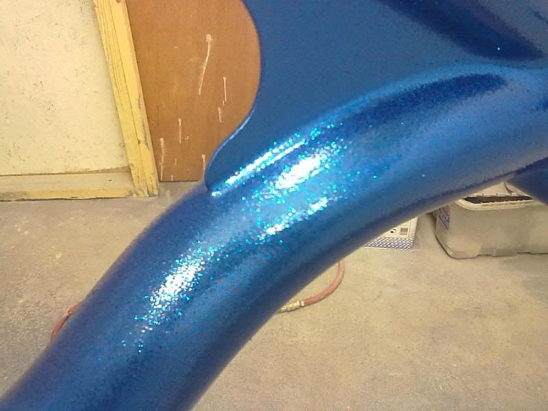

this is after approx 5 passes
this approx 20 passes
well chuffed with the way it looked in the sun
its not as rough as we expected, so just got to give it a million coats of high solids clear then flat and polish it.

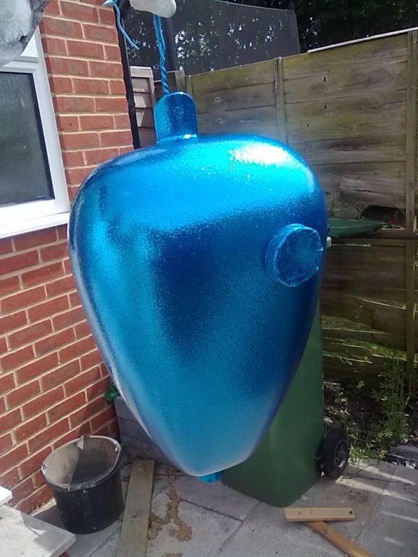

lacquered the flake, approx 30 coats, just need to flat it and polish it, happy with the results
