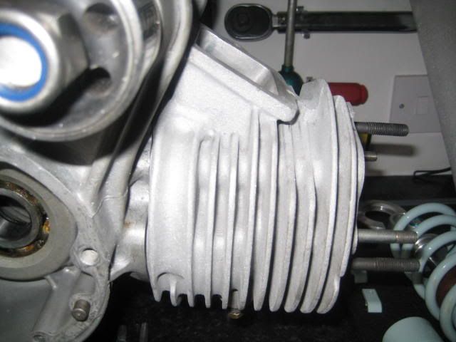

cheers for the info wack, there must be a bit to be gained or they would'nt have botherd with the extra bit on the bottom of the cylinder ?. i had this motor (carb) set up on a dyno when i first built it it would be good to see if there is any difference after my home tuning 8-)

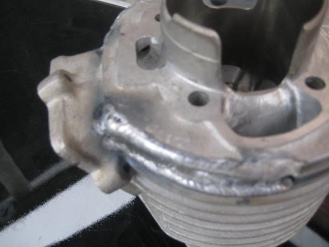

hi , just check my previous posts under imola , all this work allready done to my cyilinder and casings so i hope it helps :D

My Imolas had this done for approx 5 years now, plus extra welding to the casings to give a wider gasket face. Only really worth doing if you plan to fit a nice revvy pipe, larger carb etc. Keep gearing to approx 5.4 as you'll find you'll get 20HP quite easily but can be a touch peaky. Standard reeds help to promote torque and the racy V force ones have a rep of only lasting one good season. Would recommend fitting any of the MBD (racetour?) inlet rubbers too, never had a problem with them.

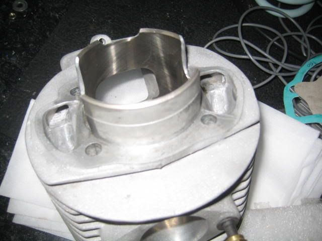

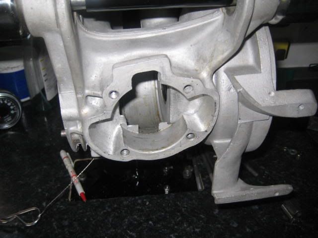

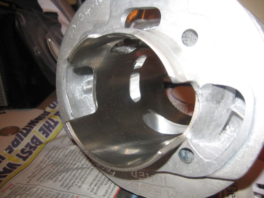

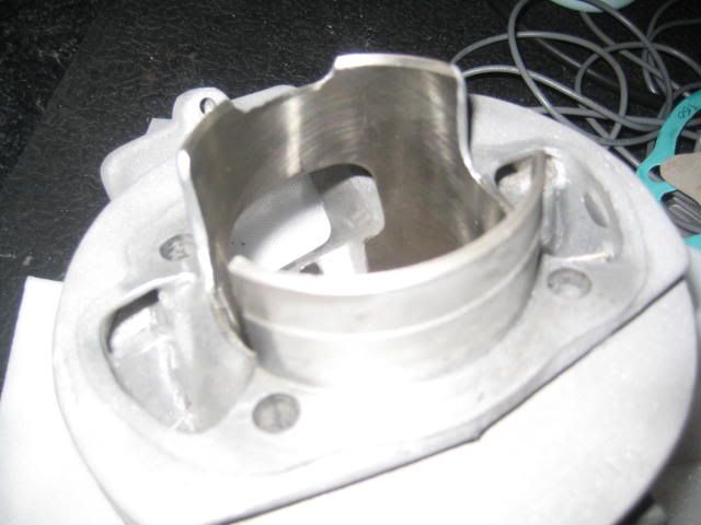

is this what your planning .............................ImageImage
Image[/photobuckvid][/photobuckvid]
boost port the same as rbs............

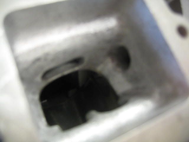

thats a bit beyond my tuning skills, but yes thats what i am after. very nice bit of work 8-) 8-) . anyway i could not resist more tinkering today, i drilled the boost port into the inlet today :D .
