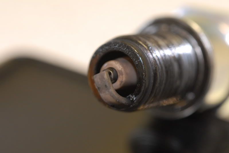

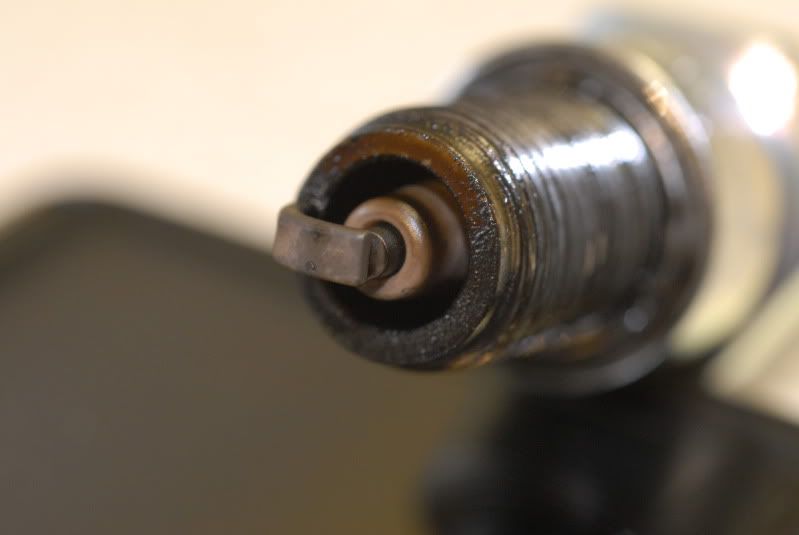

Hey guys, can I ask for a quick plug check?
Just working the pilot and needle
Just started running in my Mugello V4 small block.
Tm24,varitronic,sito ancillotti..
cheers
Bit light for me but an adult will be along to put me right lol
Daggs
Posts: 776
Location: Addington Kent
I agree, just a touch too light.
as above :D
red
Posts: 637
Location: Blyton,Lincolnshire
Not dark enough for me :D
red wrote:Not dark enough for me :D
You mean not melted enough for you... :frog:
wack 63
Posts: 1254
Main scooter: '71 GP TS1
Location: Lincs
Personally I prefer to use an old plug first as it will colour up easier than a new one will,but that's just me.
joey
Posts: 184
....looks good to me....mugello's like to run lean in my opinion.....just beware of pinking and any hesitancy in throttle response....get checked out at a rolling road to be sure and get the max out of it!......enjoy ;)
giankx
Posts: 204
Right for me, as above, Mugello like to run a bit lean.
Bufficus
Posts: 271
Joined: Wed Jan 07, 2009 1:38 pm
Location: Chelmsford, Essex
I'd be happy with that. The insulator looks right to me, which is where you want to be looking, don't worry about the electrode on a new plug.
