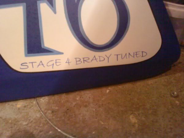

Get a good quality piston..maybe asso or the like and get some decent porting work on it..you know the man. ;) my stage 4 has exceded all my expectations..

Which of the many men would that be?

CPH Lambretta wrote:Which of the many men would that be?
The man we have both used to great effect..!!!
