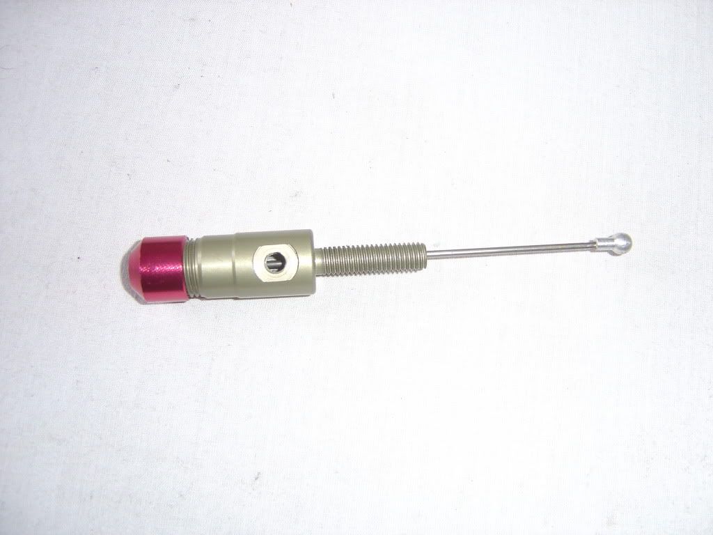

there was one on ebay a few weeks ago that used a minimoto /auto parts need some welding on the handle bar mount to accept the speed flight master cylinder bottom looked like this one that i used
shocky wrote:there was one on ebay a few weeks ago that used a minimoto /auto parts need some welding on the handle bar mount to accept the speed flight master cylinder bottom looked like this one that i used
Steve, what would thre resultant clutch action be like with say a 5 plate clutch with competion spings in?
i dont know col mine was light enough though took a bit of fiddling to get it right the main prob was locating the bit in the pic as it couldnt be muonted straight couse the cable adjuster bracket was in the way i ended up makeing a new adjuster bracket with a longer tab on to take this i got a pic some were
shocky wrote:i dont know col mine was light enough though took a bit of fiddling to get it right the main prob was locating the bit in the pic as it couldnt be muonted straight couse the cable adjuster bracket was in the way i ended up makeing a new adjuster bracket with a longer tab on to take this i got a pic some were
I'd be interested to see it if you come across it
cheers
colin

Hmm. The fact that I have a standard 1 inch bar make fitting hydrolic sylinders a piece of cake.
Looks like a neat gadget, worth a try I guess.
martinr
Posts: 129
i use one of those on my cutdown works fine
i have 2 of them left
