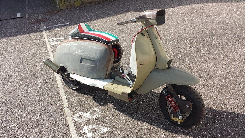

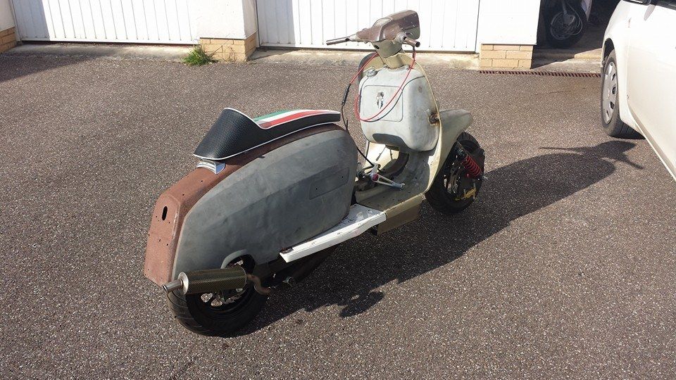

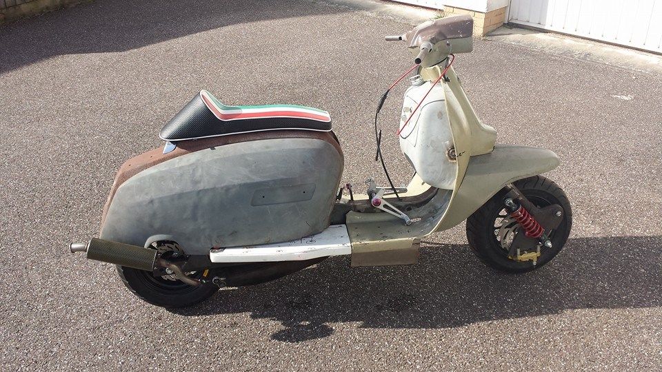

these pics were the last time that I loosely assembled it just to check how it will look, posted a couple on facebook and a few people didnt even realise at first that it was bike engined, thats really pleased me.
front brake caliper will either be vertical or running at the same angle as the fork leg, thats my current and last job to get done before thursday night

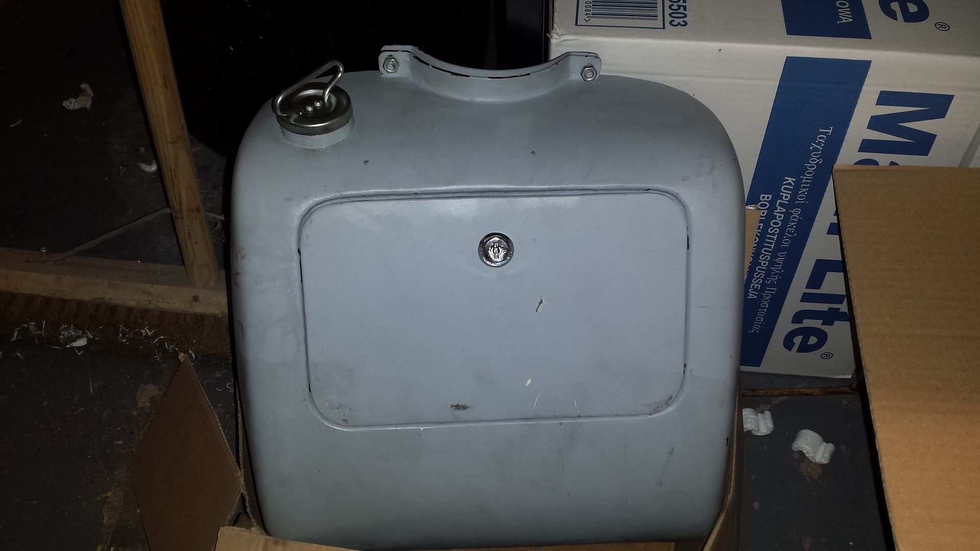

turned my attention to the legshield fuel tank I had bought ages ago when I had spare cash
what a crock of crap, the supplier very "kindly" fitted a tap for me, I decided thats no use to me as I wanted a fast flow anyway, turned the nut about 1/8th turn and nut just popped off, eventually got the tap out the tank, had been forced through the too small hole with such force that the filter housing was knackered
the boss on the tank was about 6mm long, it was tapered and the 3 threads that you could just about see must have been drawn on!!!
most unimpressed, ended up welding up that boss and then turning and welding a boss on the tank of my own, I only have MIG so had fun and games trying to seal it, however during those fun and games I found more leaks.
so now its turned into a full clean out and seal job, money I hadnt budgeted for, as well as adding an inline fuel tap as I was only able to knock up a boss with M12 internal thread, so a hose barb with short tail of fuel pipe will lead to the inline tap.

Im tempted to have one more go at the leaks, but the boss area is really building up with weld LOL
speaking of the boss, I been a right proper tw@7, all my fixings and my tools etc are M12 1.75P
I made the boss, its M12, didnt actually think about it, the hose barb rocks up and the friggin things M12 1.5p grrrr LOL
oh well should have done this in the first place, out with some brass bar, make a hose barb myself right thread.
I really wish I had made my own tank to be honest, my original thought was to pick up some legshields, and a toolbox, weld together and deal with seams etc, but I decided that I would spend the money on a made tank as its such a safety item, what a mistake, its a total crock of shite
looked ok to start with

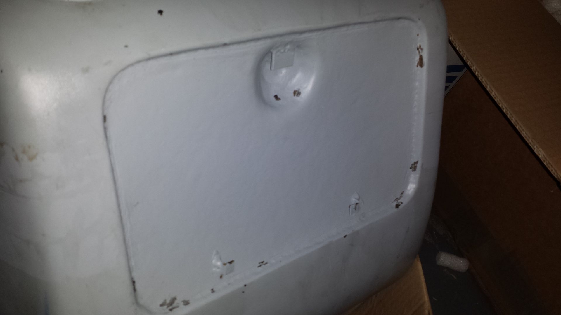

hmm the "glovebox" might just hold 1 woollen glove?? if Im lucky
think this might be a bit of a saucepan from the local curryhouse???

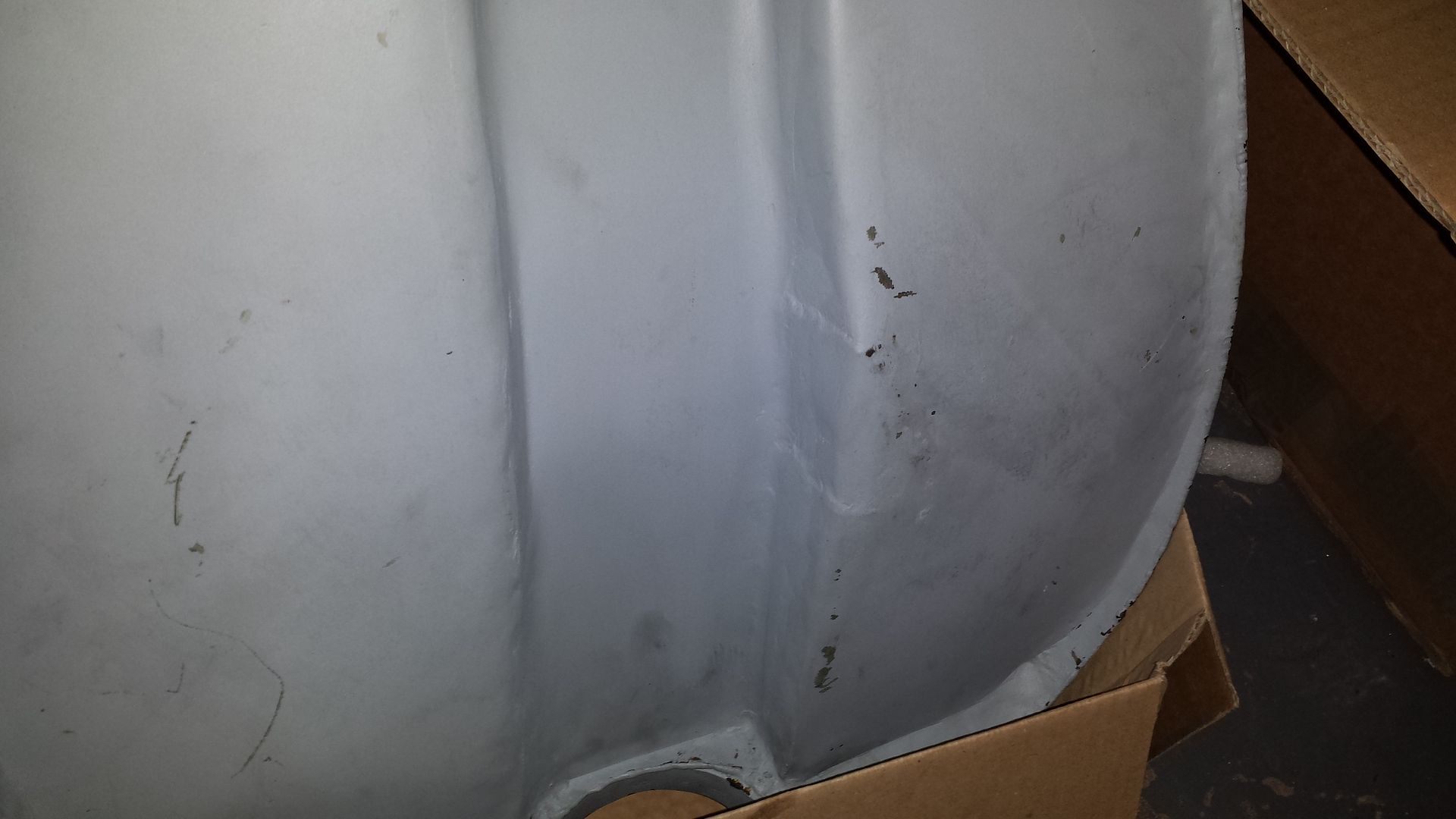

once I started to try and sand away paint to give me metal to weld mounting tabs to I found just how much filler there is over the whole thing
