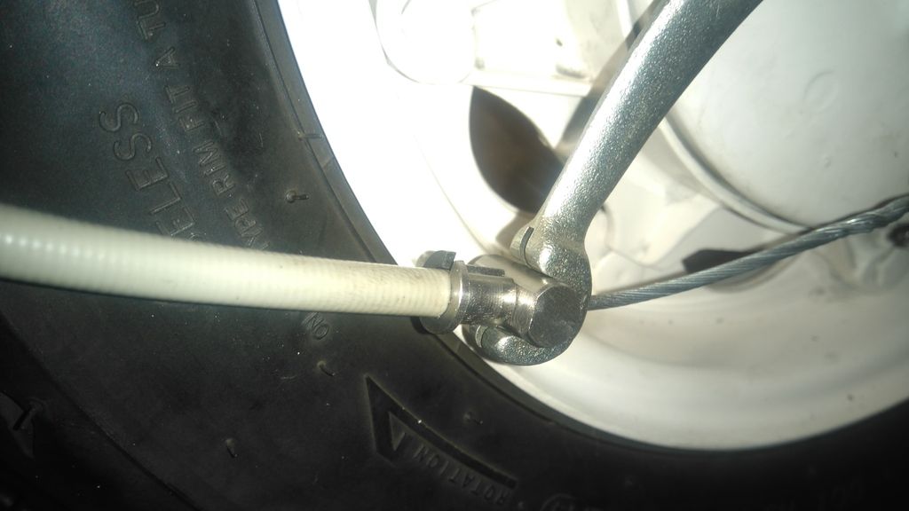

I eventually dragged my lazy arse into the garage to swap the brake arm for a longer clutch arm. There are a few fiddles required to get this working right but they're all easy.
1. Bend the clutch arm outward or it touches the rim
2. If you're using the thicker Sr brake cable you need to open out the slot in the clutch arm. Along the entire length of the slot, NOT just enough to get the cable in or the cable will follow a lazy S.
3. Get a clutch cable trunnion and file a flat for the top hat to sit on.
4. Drill the hole in the trunnion out to 3.5mm regardless of which cable you're using.
5. p155 around until you've got the inner the right length.
This picture shows what I've done to the trunnion.

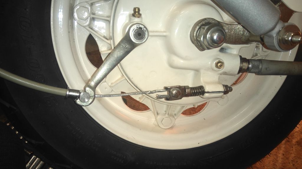

Overview of finished job. I initially didn't slot the arm properly so I didn't have such a straight pull between arm and adjuster. This would make it spongey and cause cable failure.
I've got the same stopping power as before but much more progressive.
Yes I know I need a new inner.
