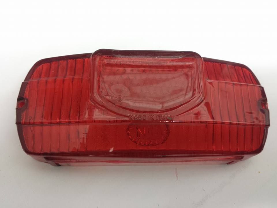

haha I was kind of thinking that direction, not sure if it was on here or my facebook page, but I had mentioned an idea with the lens, your comment might make it even better, I love sandblasting the lens, it gives a great matt finish.
removing the lettering first then sandblasting will remove and scrape marks, hmm Im liking that, maybe something to give a go :)

ok sharkman its all your fault LOL
shaved it all off minus the made in italy.
then polished it, looks good.
subtle but I know its done, thanks for sharing the idea, dont think Im going to sandblast it now, after polishing it, it looks very different

tonydevon wrote:ok sharkman its all your fault LOL
Glad you are happy with the finished product would have been gutted if you had gone to the trouble and had to bin it lol I like it too makes an off the shelf item turn into a custom item with the only cost being a smear of elbow grease. The devil is in the detail :twisted:

thats my thoughts exactly, I been building custom bikes and trikes for years, I despise seeing megabucks billet barge chops with gash wiring on show, such a simple thing to do but its nearly always the reason a bike doesnt look perfect, I love the subtle tweaks that nobody notices, generally they dont notice it because its not impressive, they dont notice it because it looks so right
I have to hold my hand up and say I had never heard of or even thought of doing that to the lens, I liked it cut down, but really like it with writing removed, I left the made in italy just as a bit of a joke, only thing italian on this build is the engine, and thats not lambretta LOL
