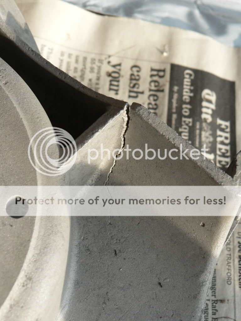

scooter is starting to come together a bit more now. Got the panels, leggies back from the bead blasters and gave them a quick spray of primer to stop em rusting. Not as bad as i thought but there are a few holes on the legshields by the bridge peice and one pannel looks as though its been dragged down tyhe road (it had).
Blasting also revealed big crank in the flywheel housing, suspect that its to far gone to be welded?

Bloody big crack....
This seems as bad as it gets...
the mag flange can be welded no prob your brake backplate the bit with the speedo drive in looks like the thin type not good if it is can you confirm what type it is
