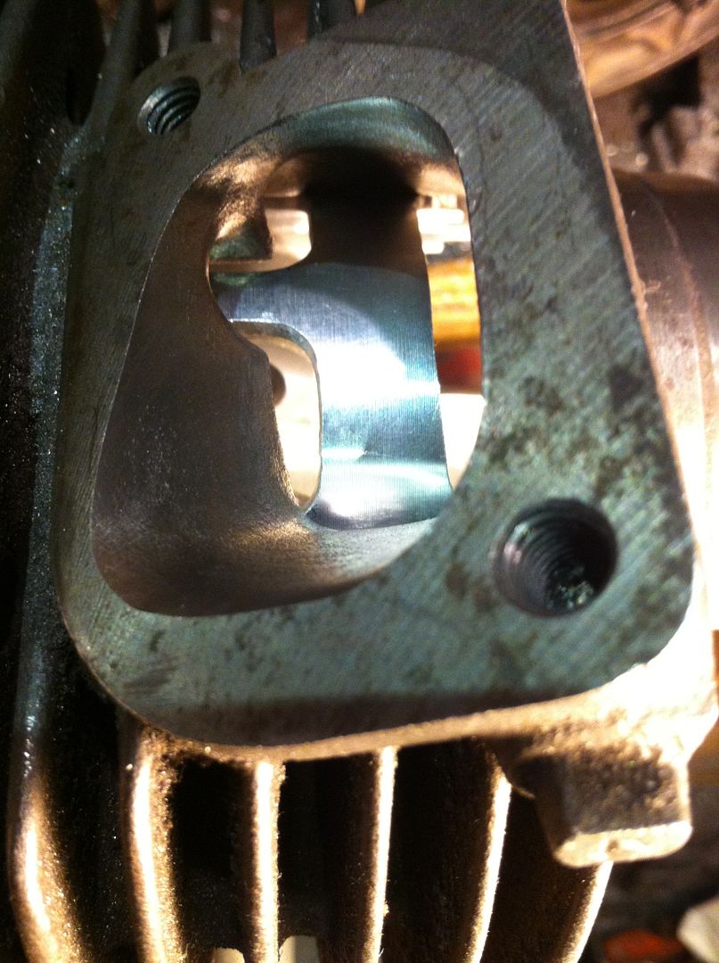

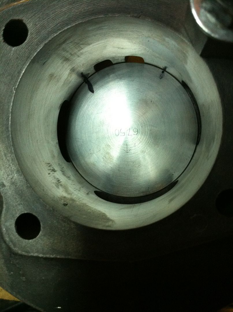

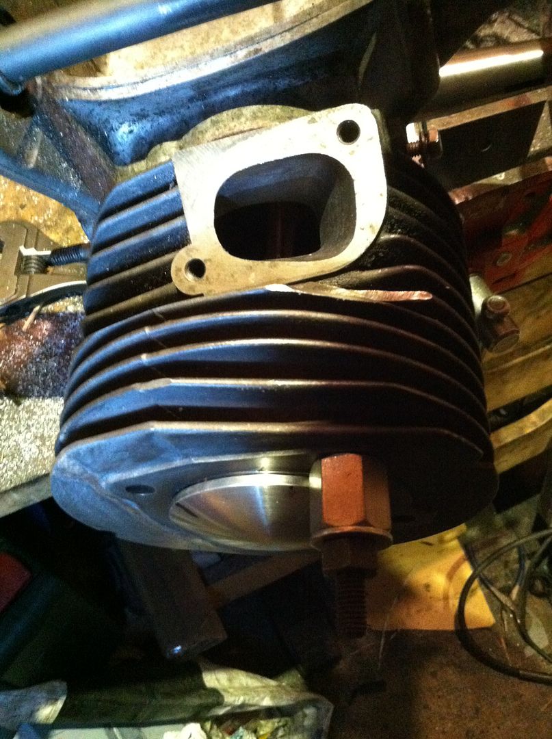

barrel rebored and back home.
my test assembly without base gasket gives a very low timing as if MB piston crown height was higher than a standard piston ( ad says no....)
T:108°
E:140°
BD: 16°!!
A pity!!
race-base (http://www.race-base.com)says:
3,2mm packer and 6,6mm to be removed at the exhaust top to get 125/180°

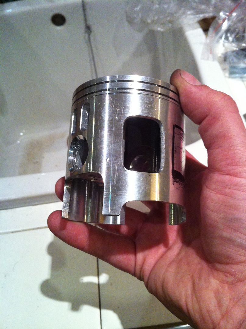

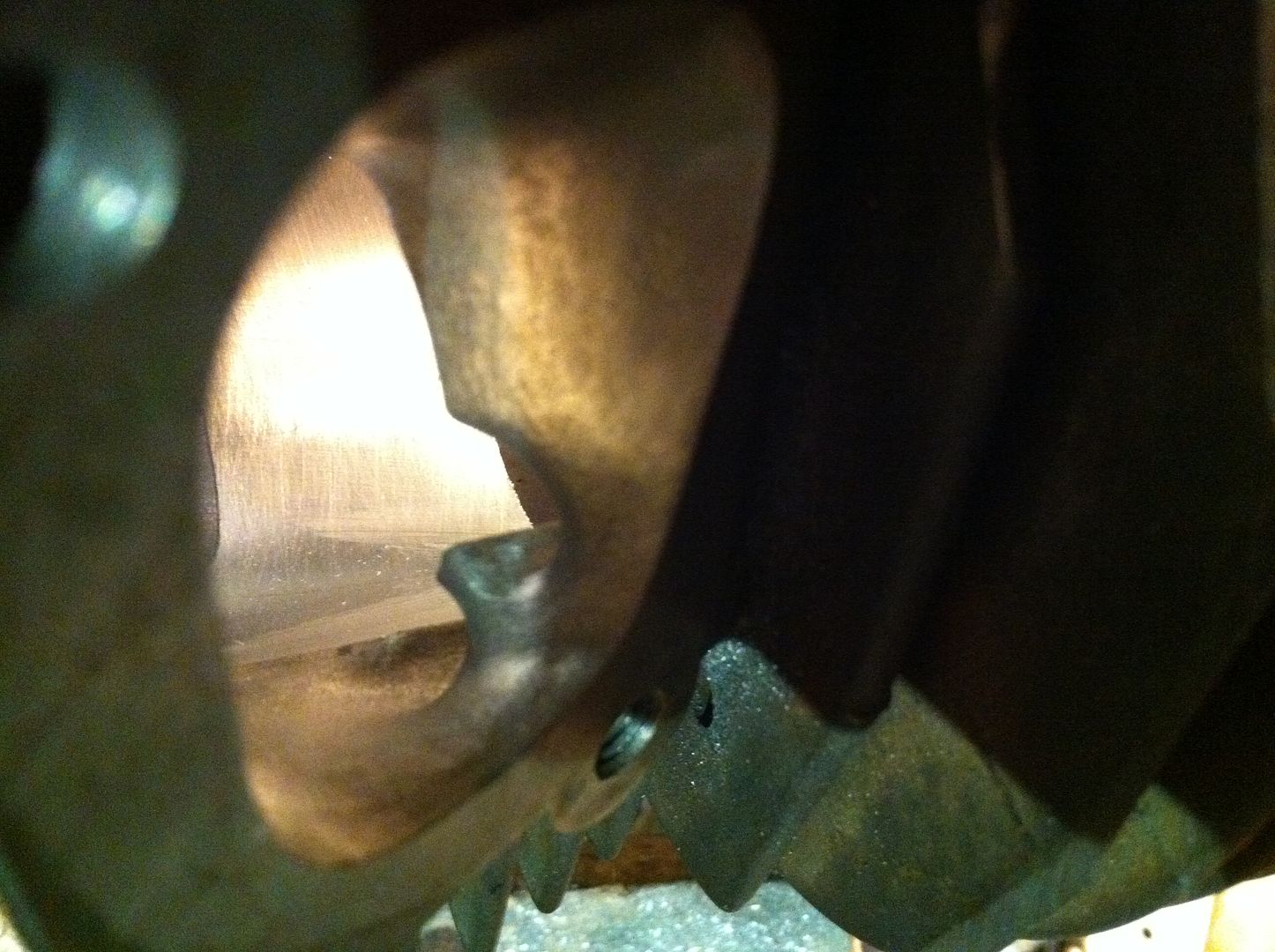

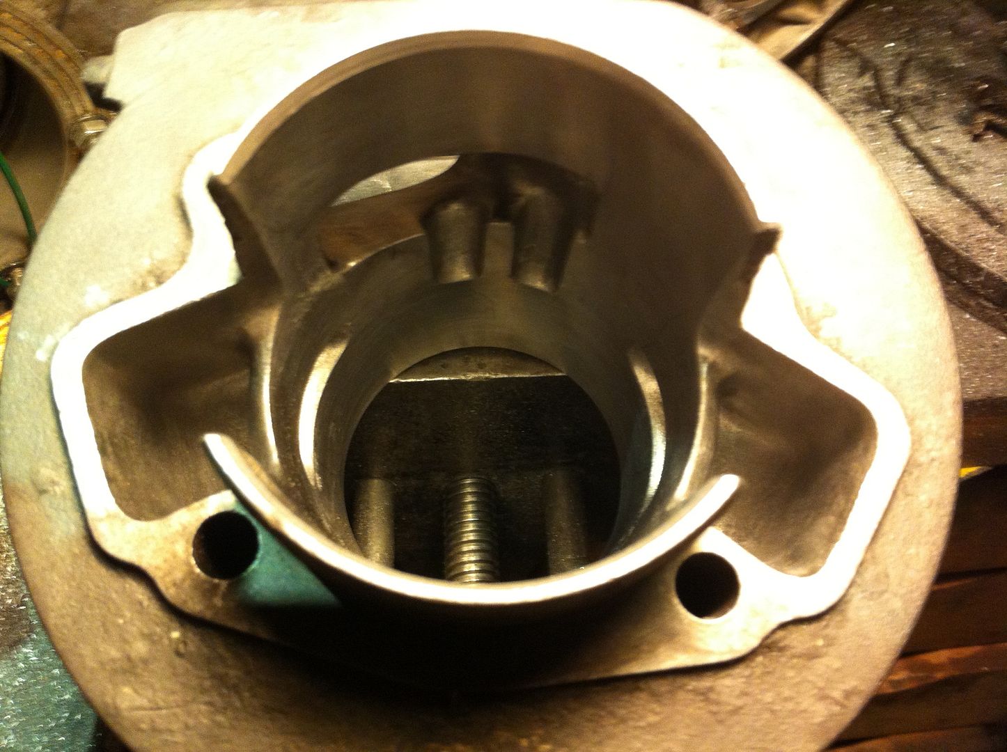

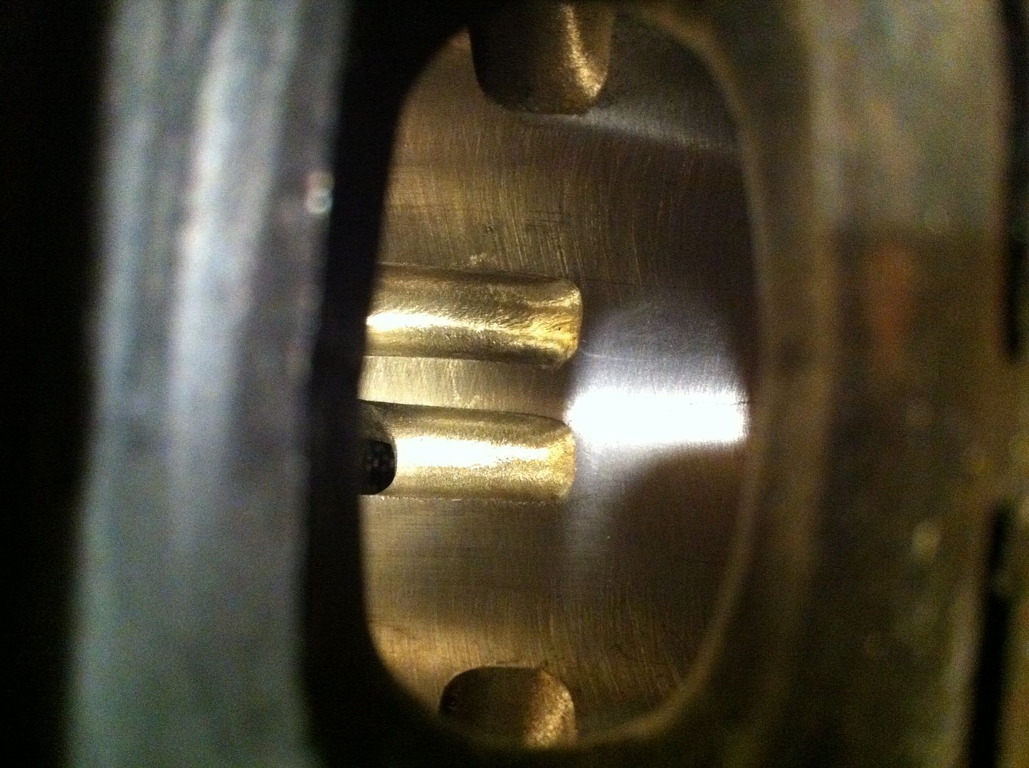

Transfers are finished:

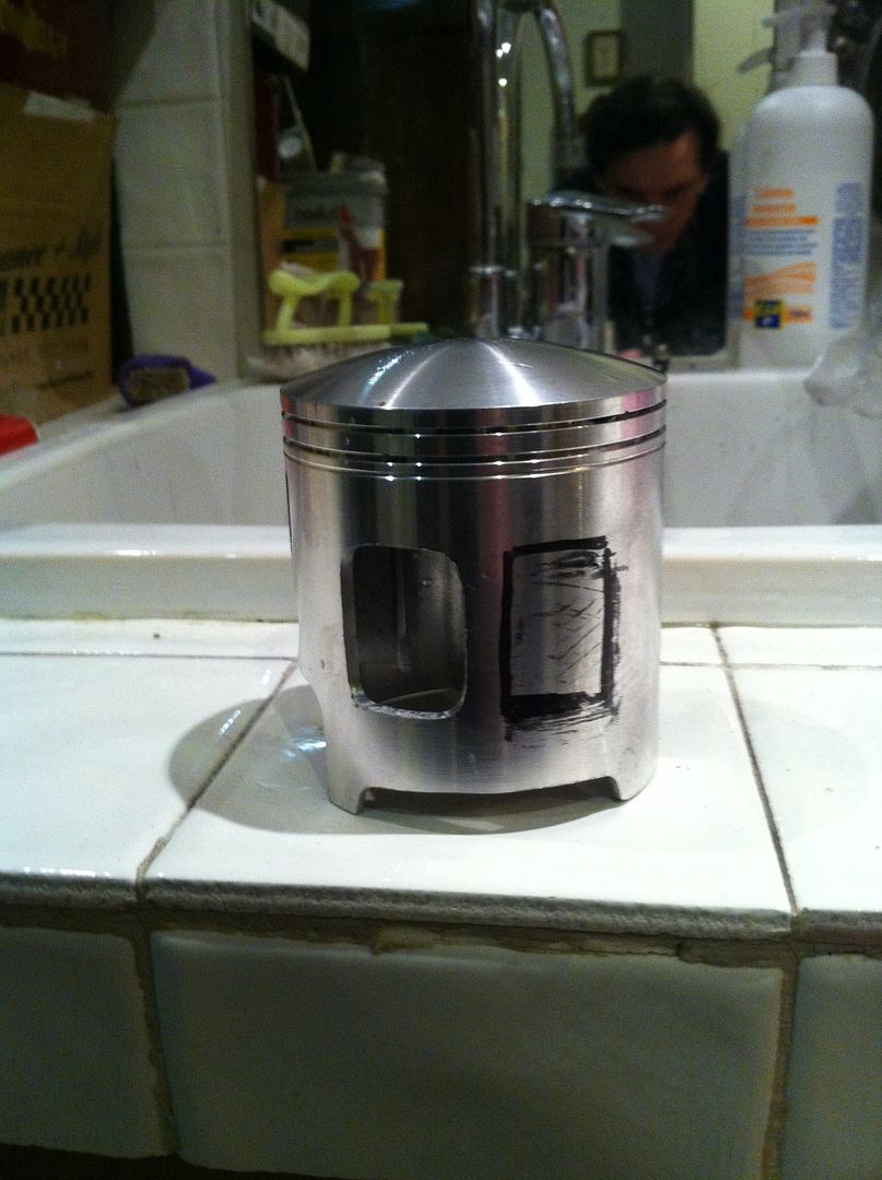

piston could look like this:
Size matters!
TED CRUD
Posts: 261
The Piston does not look happy :P
Smash Ya Pastie
Washington Posse s.c
fastfrog
Posts: 412
Location: Paris, Taxes
never smile facing the scaffold!

piston operation in progress:

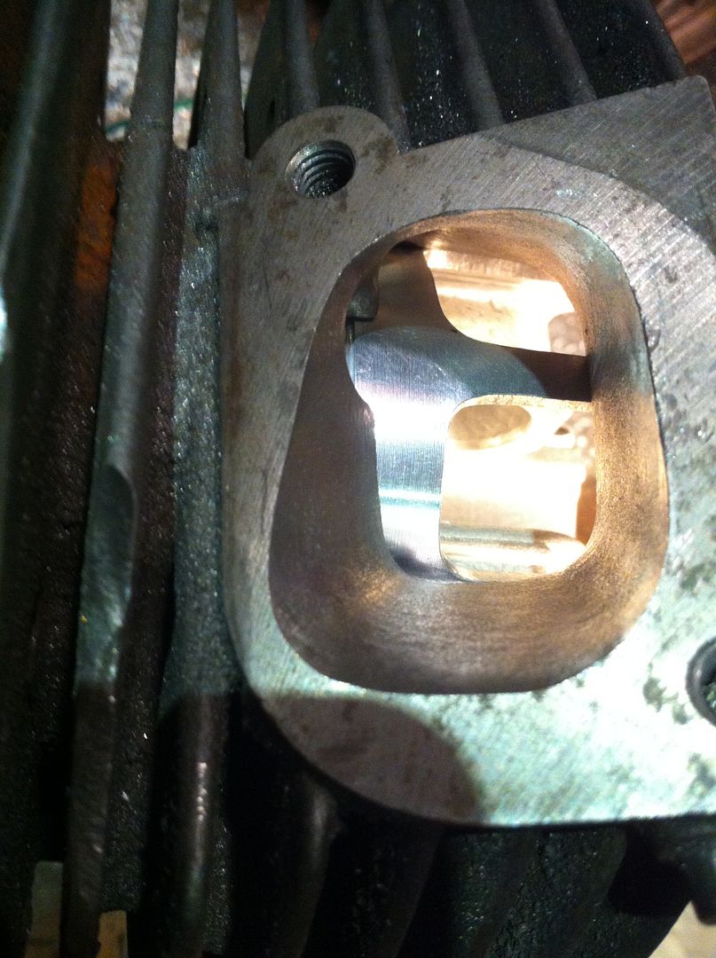

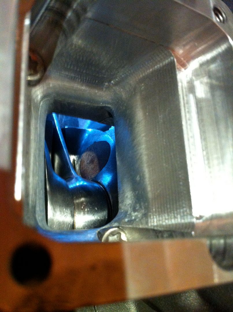

piston ported:
at BDC:
at mid range to the TDC:
from the inside (I like this one!)
