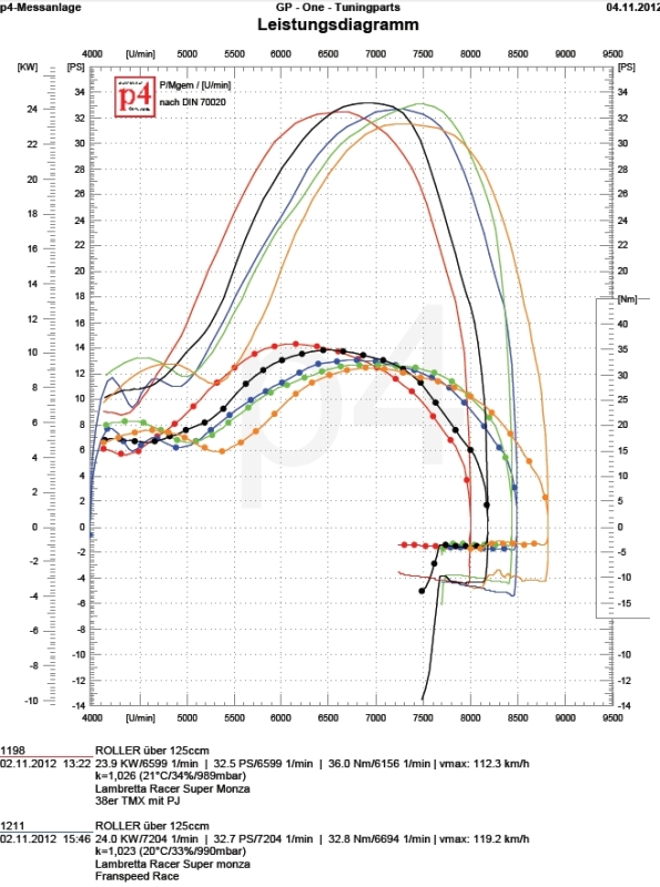

My thoughts about the Supermonza Kit after many weekends of testing, pros and cons (unported kit, all dyno graphs shown are with a totally untouched cylinder, ports in casing matched to cylinder):
The SM is the most powerful kit out of the box, both hp and torque are above all other kits now on the market. It has it´s power low down, very low down the rev range. The power band is not really wide, or in other words, the kit does not rev a lot after the early peak power. It pulls like a train with massive torque and will suit many people riding styles, but not all. It is a bit low in power before going into pipe but considering it does this at around 4350 rpm you don´t feel it on the road.
Graph one: SM Kit, SM exhaust, 30mm Dellorto CS carb, jetted as suggested
I never believed the 30mm Dellorto carb is the one and only holy thing, got slagged for it, well...here we have another comparisation: Dello 30 vs. Mikuni TMX 35 vs. Mikuni TMX 38. Dello carb as suggested, on the Mikunis just the main jet was changed, hence the not ideal running lower down with the 35.
Graph two and the clear winner is the 38mm carb, bettering the Dellorto by 2,3 bhp, 1,5Nm, same low down behaviour and it widens the power band by 500 revs

For the exhaust test I used the 38 mm carb. Exhausts tested on this day:
Supermonza exhaust (italian version) vs. Franspeed Race vs. Ludwig und Scherer Tourist vs. Ludwig und Scherer Reiseleiter. The latter 3 exhausts are all TS1 pipes NOT made for the portarea of the SM Kit, but the Ludwig and Scherer pipes have a bigger Diameter at the flange then the average TS1 exhaust. All TS1 exhausts, especially the L+S ones, need more blowdown lead time, which (strangely for me) the auxiliary ex ports couldn´t compensate. This will be interesting later on the ported kit..the Reiseleiter, which usually gives top power and a wide band doesn´t work with this original setup.
graph 3, SM (red), Franspeed race (blue and green), Tourist (black), Reiseleiter (yellow)

here is a comparisation between a road ported TS1 with Franspeed race pipe (but 35mm carb, fixed ignition) and the untouched SM (38mm carb, varitronic) with the Franspeed race pipe on the same dyno
graph 4: SM franspeed (red, blue) and TS1 Franspeed (green)

The kit for auction came with carbon reeds, a kit a friend of me bought came with fiber reeds. I thought the carbon reeds will give better top end and fiber reeds better low down power. How wrong. The carbon reeds topped the fiber ones in the best case (cold engine vs cold engine) nearly 1 bhp over the whole rev range. In the last hmm maybe 400 revs the fiber reeds were a little bit better, but not really affecting the performance.
Next on the agenda was a swap of heads. Gravedigger from MMW did two heads for the kit. I tried the one from these two with lower compression first. See pics on FB site for comparisation of the heads, they are 50% squish area - more squish area, msv and higher compression then the standard head as well. Power kicked in a tad earlier than the SM head and torque is now 37,7 Nm or 27,29 lb/ft @ 5950 rpm. Power also raised to 35,5 bhp @ around 6500 rpm - hold on - this run was with the 30mm carb :-) and L+S Tourist exhaust. On the downside, the band was shortened a bit.
Just because it was on hand and without big interest to the public, I tried a Genesis Big Air CNC carb from US-based sled tuners PSI. This carb has a triangular venturi, making it behave like a 30mm carb at low throttle opening and a 38 mm carb on fully opened slide. I was in fact VERY impressed by the performance from this carb as it added 1 bhp+ over the whole rev range. It is a carb with no jets, main jet is an adjustable power jet type, the needle can be raised/lowered with an allen key from the outside, I love it. Downside is the price of ~1100 USD, making it maybe a choice for racers when everything else is tried and done.
