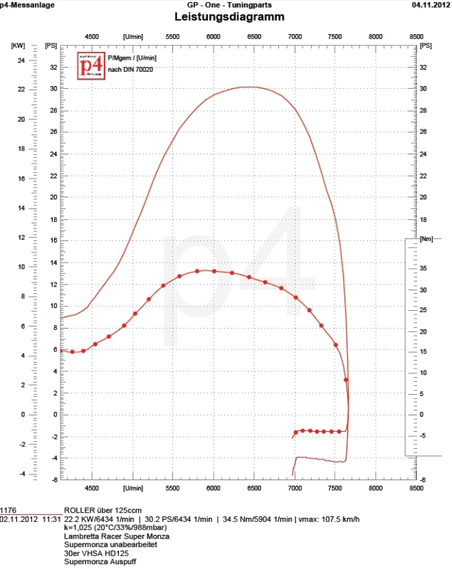

My thoughts about the Supermonza Kit after many weekends of testing, pros and cons (unported kit, all dyno graphs shown are with a totally untouched cylinder, ports in casing matched to cylinder):
The SM is the most powerful kit out of the box, both hp and torque are above all other kits now on the market. It has it´s power low down, very low down the rev range. The power band is not really wide, or in other words, the kit does not rev a lot after the early peak power. It pulls like a train with massive torque and will suit many people riding styles, but not all. It is a bit low in power before going into pipe but considering it does this at around 4350 rpm you don´t feel it on the road.

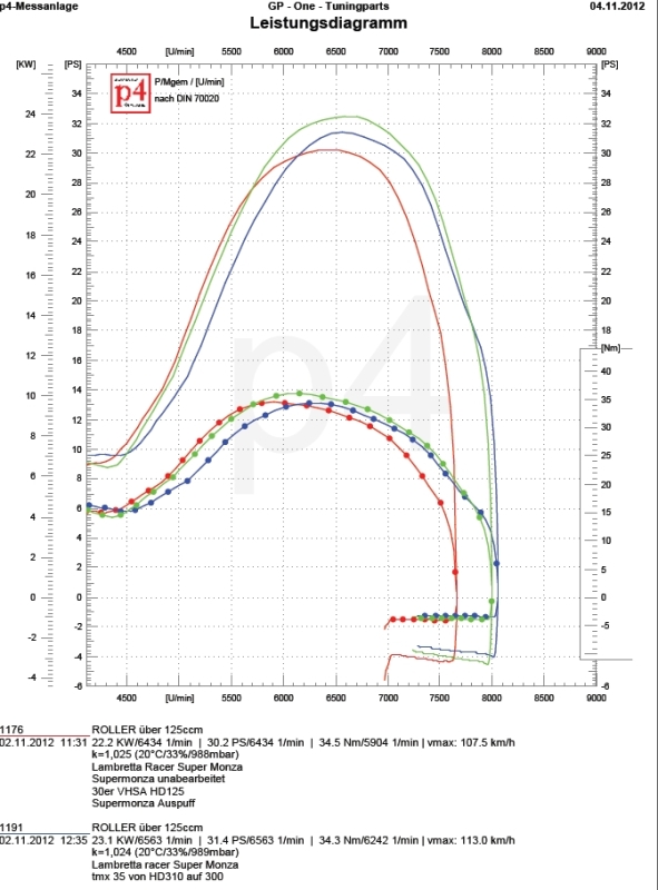

Graph one: SM Kit, SM exhaust, 30mm Dellorto CS carb, jetted as suggested
I never believed the 30mm Dellorto carb is the one and only holy thing, got slagged for it, well...here we have another comparisation: Dello 30 vs. Mikuni TMX 35 vs. Mikuni TMX 38. Dello carb as suggested, on the Mikunis just the main jet was changed, hence the not ideal running lower down with the 35.
Graph two and the clear winner is the 38mm carb, bettering the Dellorto by 2,3 bhp, 1,5Nm, same low down behaviour and it widens the power band by 500 revs
