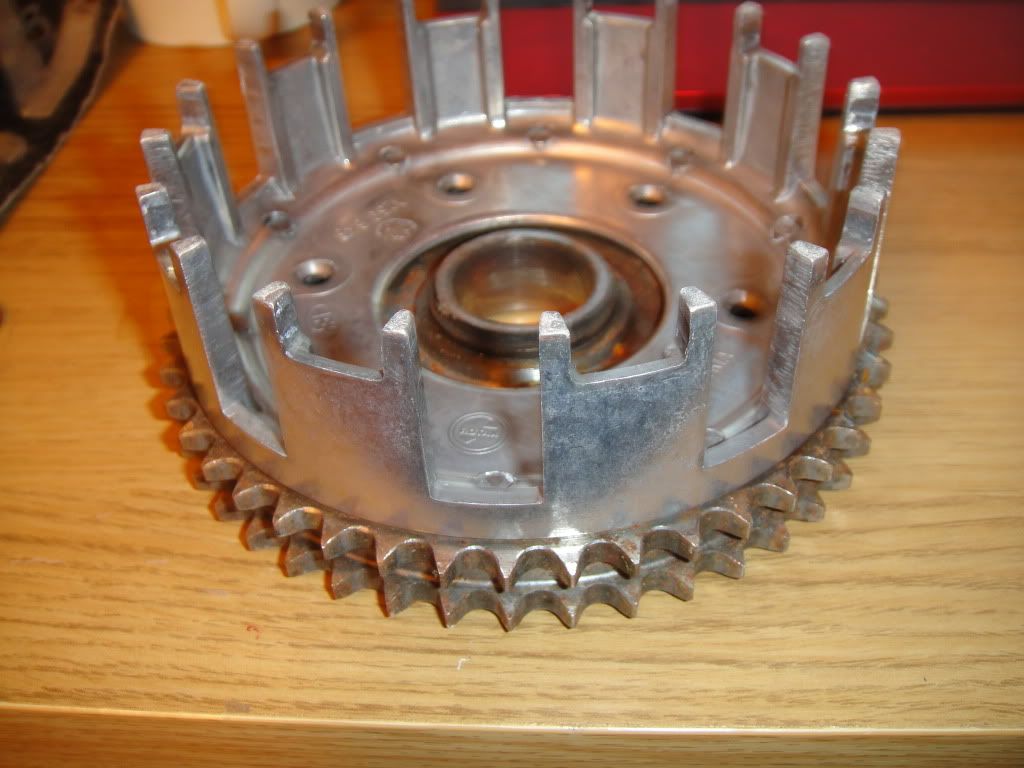

right got me clutch ,basket removed from primary gear now hunting for the basketless lammy crownwheel somewhere in the house (or shed possibly)....first thing i noted was lammy steels are slightly too big to drop in the rotax basket ....so what do your steels £££??

You'll need a 47 tooth crown wheel. Fitting an Aprilia basket into a 46T duplex sprocket with leave you with 2 x 46T simplex sprockets unless you put the basket on the lathe which is a bit tricky.

well i went looking anyway and found it (i wont be told)
you were right of course :cry:
so .........wanted 47 tooth crown wheel :freak:
